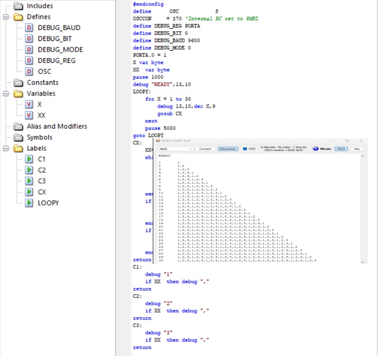

Re: Avoiding too many GOSUBs, possible?
I Assume your objective is to get something like this
READY
1 1
2 1,2
3 1,2,3
4 1,2,3,1
5 1,2,3,1,2
6 1,2,3,1,2,3
7 1,2,3,1,2,3,1
8 1,2,3,1,2,3,1,2
9 1,2,3,1,2,3,1,2,3
10 1,2,3,1,2,3,1,2,3,1
11 1,2,3,1,2,3,1,2,3,1,2
12 1,2,3,1,2,3,1,2,3,1,2,3
13 1,2,3,1,2,3,1,2,3,1,2,3,1
14 1,2,3,1,2,3,1,2,3,1,2,3,1,2
15 1,2,3,1,2,3,1,2,3,1,2,3,1,2,3
16 1,2,3,1,2,3,1,2,3,1,2,3,1,2,3,1
17 1,2,3,1,2,3,1,2,3,1,2,3,1,2,3,1,2
18 1,2,3,1,2,3,1,2,3,1,2,3,1,2,3,1,2,3
19 1,2,3,1,2,3,1,2,3,1,2,3,1,2,3,1,2,3,1
20 1,2,3,1,2,3,1,2,3,1,2,3,1,2,3,1,2,3,1,2
21 1,2,3,1,2,3,1,2,3,1,2,3,1,2,3,1,2,3,1,2,3
22 1,2,3,1,2,3,1,2,3,1,2,3,1,2,3,1,2,3,1,2,3,1
23 1,2,3,1,2,3,1,2,3,1,2,3,1,2,3,1,2,3,1,2,3,1,2
24 1,2,3,1,2,3,1,2,3,1,2,3,1,2,3,1,2,3,1,2,3,1,2,3
25 1,2,3,1,2,3,1,2,3,1,2,3,1,2,3,1,2,3,1,2,3,1,2,3,1
26 1,2,3,1,2,3,1,2,3,1,2,3,1,2,3,1,2,3,1,2,3,1,2,3,1,2
27 1,2,3,1,2,3,1,2,3,1,2,3,1,2,3,1,2,3,1,2,3,1,2,3,1,2,3
28 1,2,3,1,2,3,1,2,3,1,2,3,1,2,3,1,2,3,1,2,3,1,2,3,1,2,3,1
29 1,2,3,1,2,3,1,2,3,1,2,3,1,2,3,1,2,3,1,2,3,1,2,3,1,2,3,1,2
30 1,2,3,1,2,3,1,2,3,1,2,3,1,2,3,1,2,3,1,2,3,1,2,3,1,2,3,1,2,3
MY code that produced the printout in #4 called digit 1 ,2 and 3 subs [c1 c2 c3 ]as needed when the input is broken down
Attachment 9519
you can remove all the gosubs entirely with a bit of thought to get the same printout
LOOPY: FOR X = 1 TO 30
DEBUG 13,10,DEC X,9
GOSUB CX
NEXT
PAUSE 5000
GOTO LOOPY
CX:
XX = x
y = 0
WHILE XX
DEBUG 49 + y
y = y + 1
if y == 3 then y = 0
Xx = Xx - 1
IF XX THEN DEBUG ","
WEND
