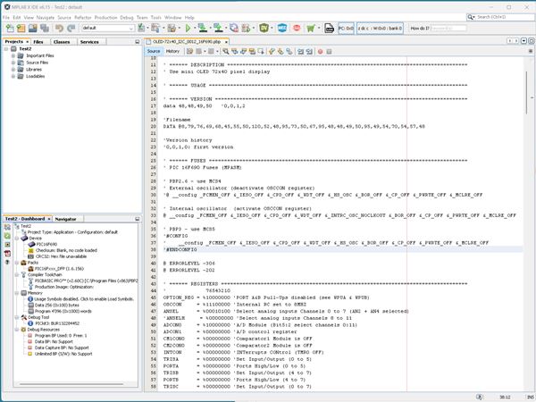

So MPLAB X IDE v6.15 is now installed on my PC, I followed this video that helped me to do the trick.
Attachment 9516
https://www.google.com/search?q=picb...HxbGHVR_4,st:0

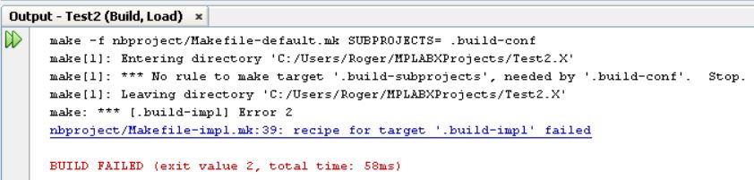

Now to the point: I'm stuck on an error I can't find the solution for now.
Here it is:
Attachment 9517
Did somebody already have the same issue and could come up with a solution please?
		Re: MPLAB X IDE v6.15 - "makefile" issue
	Quote:
			I'm trying to gets things up and running with MPLAB X IDE. Not really sure I really need it but it looks so cool
 MPLABX stopped being a useful IDE for pbp  after ver 2.35, ceased to function even as a crippled alternative IDE after ver 3.55 and worse still after ver 5.55
they stopped using mpasm at all making it totally and completely incompatible with pbp.
pbp just never kept up with the times
		MPLABX 5.35 is the last version that works with PBP.
		Thanks Ioannis.
I'll revert to version 5.35 :wink:
