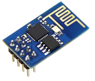

wifi is the easy way , just add an esp module or a socket for one
Bluetooth text file transfet from mobile phone to PIC - rookie's question
Like i.e. this one?
Attachment 9503

esp01 modules tend to have smallish flash chips installed something with a 4meg or bigger flash is better. [wemos d1 mini or d1 mini pro]
i set the esp up as a simple web server. user can upload/download files from the server via a html script using any sort of browser.
the esp can then send or fetch the file data from the pic via a ttl serial connection or spi or i2c or whatever floats your boat at whatever speed you like
whenever you like. no special software is needed at all in your browser for most common file types to upload or download successfully
https://www.picbasic.co.uk/forum/sho...776#post154776

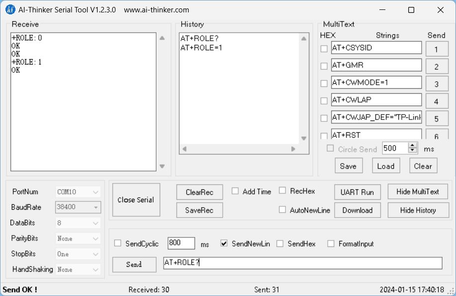

After many hours of trying and trying again, none of my four HC05 modules are willing to accept the "Master" Role. I assume this is why I couldn't establish a serial link between them :confused:
This is the most common example of HC05 modules configuration:
' Slave Configuration:
' AT+RMAAD (To clear any paired devices)
' AT+ROLE=0 (To set it as slave)
' AT+ADDR (To get the address of this HC-05, remember to jot the address down as it will be used during master configuration)
' AT+UART=9600,0,0 (To fix the baud rate at 9600)
' Master Configuration:
' AT+ROLE=1 (To set it as master)
' AT+CMODE=0 (To connect the module to the specified Bluetooth address and this Bluetooth address can be specified by the
' binding command)
' AT+BIND=xxxx,xx,xxxxxx (Now, type AT+BIND=98d3,34,906554 obviously with your respective address to the slave. Note the
' commas instead of colons given by the slave module)
Every time I send the command AT+ROLE=1, the answer is OK but if I check with AT+ROLE, the answer is always +ROLE:0.

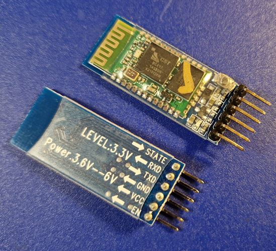

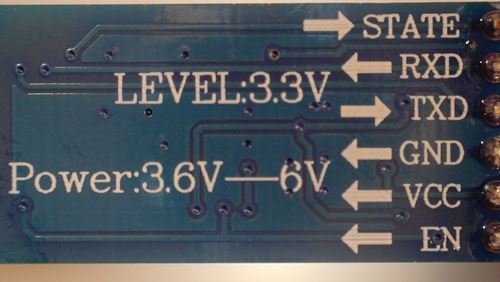

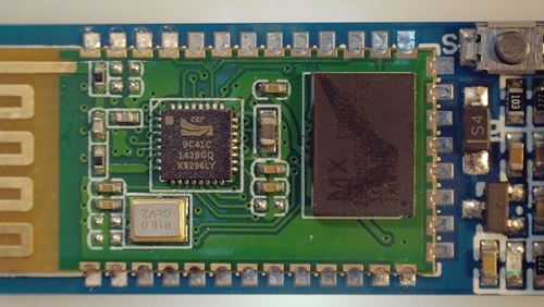

These are my modules:
Attachment 9532 Attachment 9533

I have used these modules. You need to ensure that the interface to the module works @3.3V not 5V. I just re-looked at my C code and see that there is zero initialisation that I have used with the modules. They natively connect akin to a serial UART and you can use a BT serial terminal to read/write to it. I have not used a single AT command in the code, and it works.

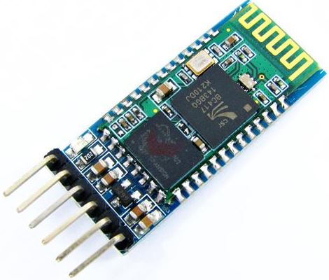

I finally ordered new and different (looking) HC05 modules.
Attachment 9534
These ones have two almost equally sized black chips unlike the ones I have on my desk so they might be a little différent.
So wait and see...
2 Attachment(s)
Bluetooth text file transfer from mobile phone to PIC - rookie's question
Just received the "new" modules and guess what?
Attachment 9561
These are the ones I have now.
Attachment 9562
I finally can start my tests :wink:
