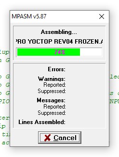

MCSX 5.0.0.5 If I compile a program at 9.00am I easily find the hex file with the timestamp of 9.00am. But then, compiling the same program, with same name, at 9.30am does not give me a new hex with a 9.30 timestamp. Even if I delete the previous hex first. If I then search my PC for *.hex I cannot find a new one at 9.30.
MCSX runs this little window successfully and quickly every time:
Attachment 9466
Some days it works, some days it doesn't, and I can't see the reason it changes from day to day.
Any help appreciated, thanks
