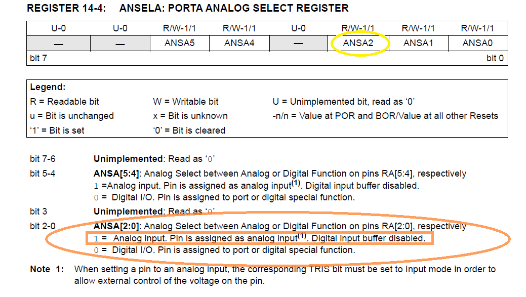

ANSELA = PORTA.2 ' MAKE ANALOG INPUT
ANSELC = %00000 ' MAKE DIPSWITCH INPUTS DIGITAL
as pointed out by tumbleweed won't do anything like what you need
a pointless statement without the code that's in playQuote:

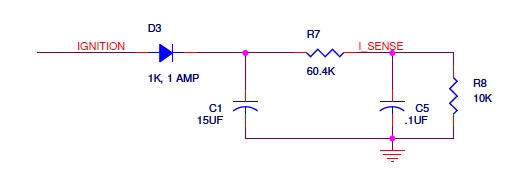

what voltage do you expect on the ignition input ?
is this expected to work in an automobile environment ?

here's rough schematic again - sorry for the wild goose chase guys - really appreciate the help.
Q2 is only driving the gate of some P channel mosfets. With the load attached to the drain of the mosfets, pin 3 on PIC wont drive the base - the program leaves the main loop - it resets.
If I release the load and turn on NPN and then turn on load, it stays on.
I was aslo thinking of changing the circuit to a double npn and reverse the logic - thus the PIC wouldnt see the 2nd NPN, but I'd like to know why its behaving this way.
you are making this very difficult,
every schematic so far is different some are worse than others
the latest is doubtful r17 is too big 3k3 would be more realistic
this is very bad

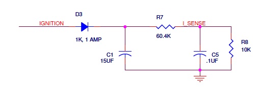

Attachment 9442
given that vin high is vdd*0.8 and vin low is vdd*0.2
a 12 volt input lands slap bang in the middle nowhere land , the slightest bit of noise could swing it either way
