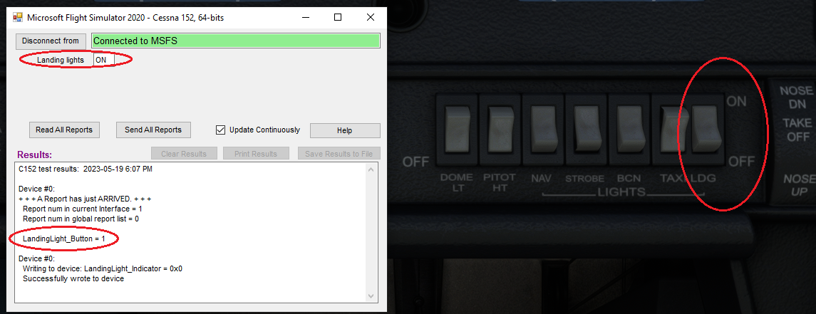

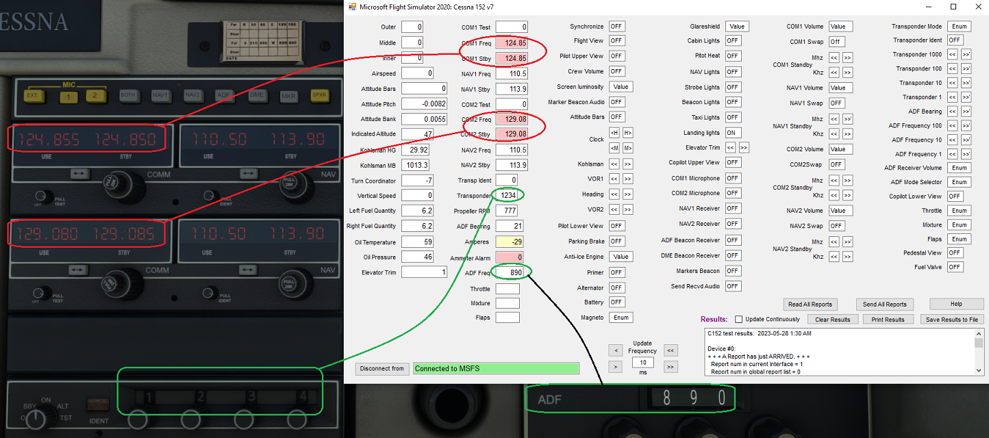

My new project is slowly taking shape; all the buttons, knobs and switches for a Cessna 152 in MicroSoft Flight Sim 2020.
https://i.imgur.com/x5nXw70.png

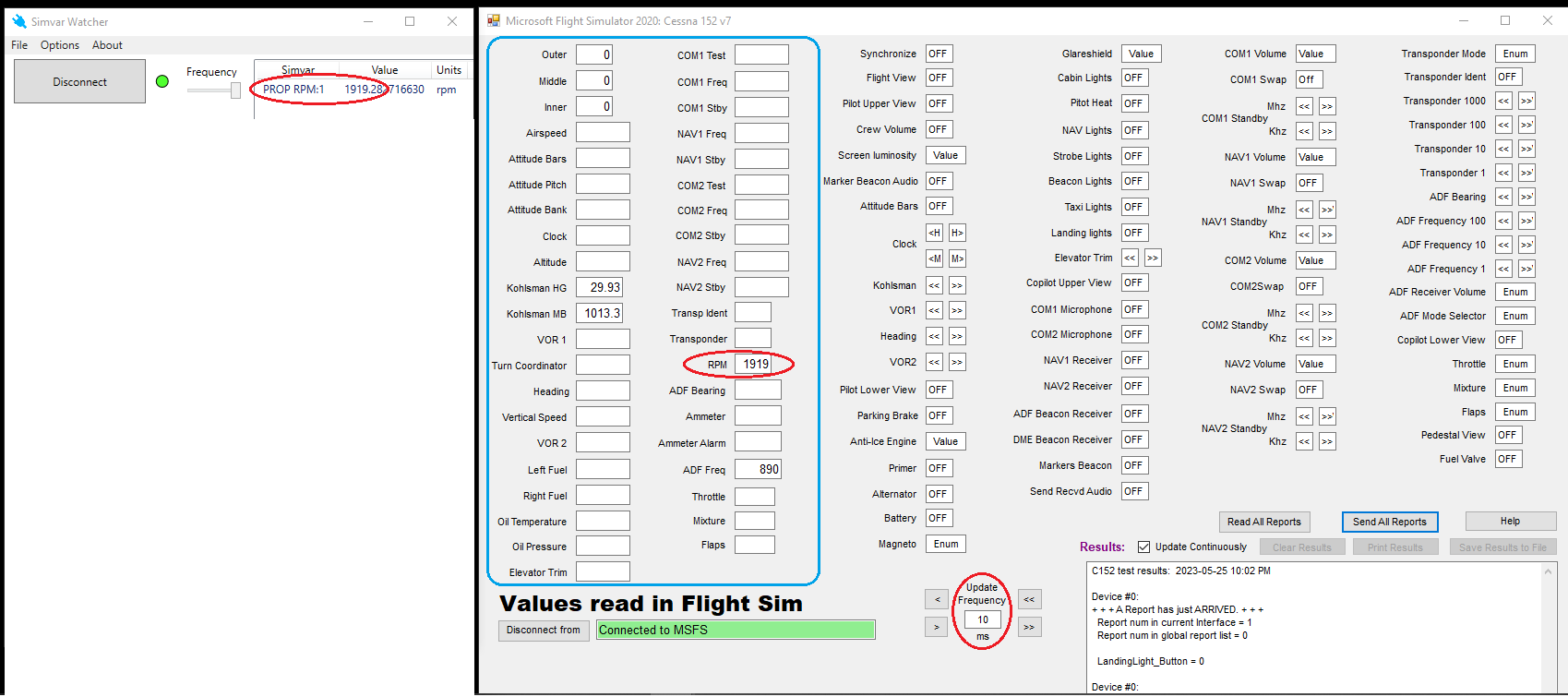

That was using a utility to get to Lvars, but I can't use it for all my objectives. It doesn't look like much, but I had to get familiar with Visual Studio 2022, learn C++ and get familiar with SimConnect.
I've since moved on to my own standalone Windows GUI in C++. I can finally get to the SimConnect Events, SimVars as well as those dreaded Lvars.
https://i.imgur.com/IVGVNj9.png
I can get to all the FlightSim controls via my program. Now I have to get the USB communication going between a 18F4550 and my program.

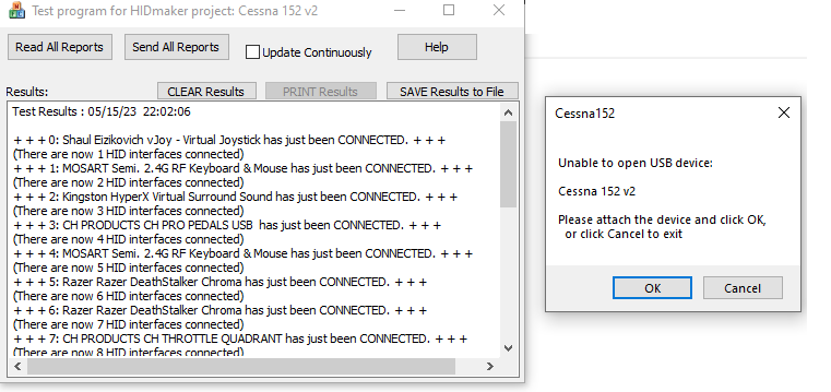

Then, got the PICkit 4, spent a ridiculous amount of time to get it working, but it's still not quite right. Turns out I found my U2 USB programmer and it works just fine, in fact, it's faster than the PK4. So the PK4 is going into a TO-DO-ONE-DAY drawer...
Been setting up a room into a small shop, putting up all my cabinets and stuff. Turns out I really need to make an inventory system caause now I'm ordering parts I already have, somewhere, that I find the very next day a shipment comes in from DigiKey.
My Aoyue 738 soldering station crapped out; the bits weren't heating at the very tip, even brand new ones. Wasted too much time on that too, gave up and got a Weller WE1010NA from Amazon. Looks decent, haven't tried it much yet except turning on and seeing how fast it heats; real heavy transformer, digital display, comfy non-slip tool that can't fall out the holder (like my antique Weller), and heats super fast.
EasyHID generated obsolete VB6 code, and of course I can't find my VB6 Development CDs. You can't just slap VB6 code into VS2022, so I paid the money and got an upgrade to HIDmaker FS2 cause it seemed to be the answer to my prayers; it can generate PBP3, and .Net C++ WinForm code. Turns out WinForms isn't what I wanted, I just ran off in the wrong direction with that. :D

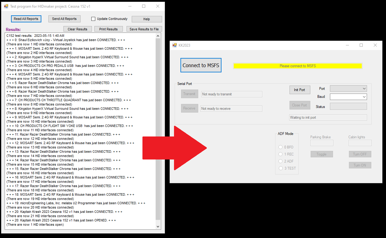

How to tailor that Windows form to my needs is another problem. It's not the standard super-simple GUI with text boxes and buttons. It uses a formatted Windows system that I'm not familiar with. That's another thing I have to muddle through.
Like this:
Attachment 9406
Re: New project - MSFS C++ USB interface
I have Visual Studio Pro 2015 (paid), VS 2017 Community (free), and VS 2022 Community on my computer. I've noticed many of the YouTube tutorials are using 2017, even though it is 2 versions old. Even though I loaded VS 2022, I have yet to play with it. I have, however, started using the free VS 2017 which does things my Pro VS 2015 cannot.
Actually, it creates the main window, and splashes a familiar sub-window if I'm not connected. As soon as I'm recognized, that pop-up disappears, looked through the code and haven't found it yet.
Attachment 9407
I have figured out that the "main window" is controlled by Manifest in the project Configuration properties and the Resource file. Gotta google to learn more, never touched that stuff before.
I'm still in limbo without access to my other laptop, but I modified the code so that if I wanted to debug the VB side without actually connecting, I would click "Cancel" and a new pop-up (which I created) would ask if I wanted to work off-line. I remember what I modified was one of the HIDmaker main page routines near the top having to do with On Opening or On Connect or something like that. Look for the code that includes the pop-up and start there.

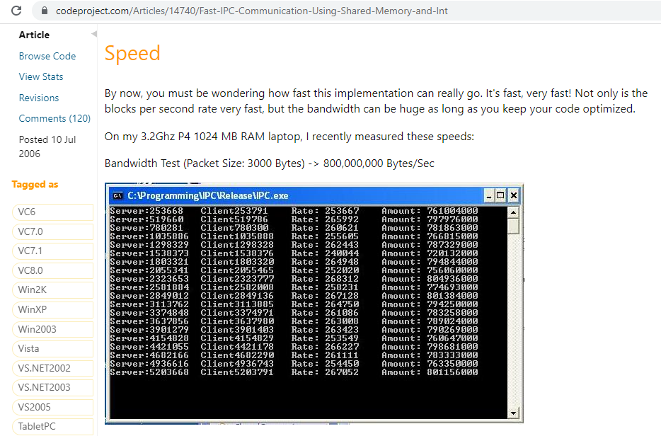

Holy moly, talk about a rabbit hole, searching for "communicating between x86 and x64 C++ programs". :D
I've narrowed it down to IPC Shared Memory using Boost (staying away from pipes, sockets, RPCs and what-nots). It's been used successfully by a lot of programmers.
https://www.boost.org/doc/libs/1_82_...processes.html
This guy got it working:
https://stackoverflow.com/questions/...24381#63224381
So far, BOOST has come up the most in the threads I've gone through. Now I just have to find a really basic working code. Usually it's just bits and pieces here and there, just enough to get me all excited, but not enough to compile without knowing things like "how to adapt code to your needs without having had a C++ course in your life". :D
But at least I have an option if HIDmaker can't be adpated to x64 in the near future. It just adds a layer of complexity I could do without.
EDIT: So how fast can data be transferred using IPC shared memory?
Attachment 9415
And this is on a Pentium 4, I'm running something slightly faster with a bit more RAM. :D
I was planning on sharing about that volume of bytes too, 1 or 2 K.

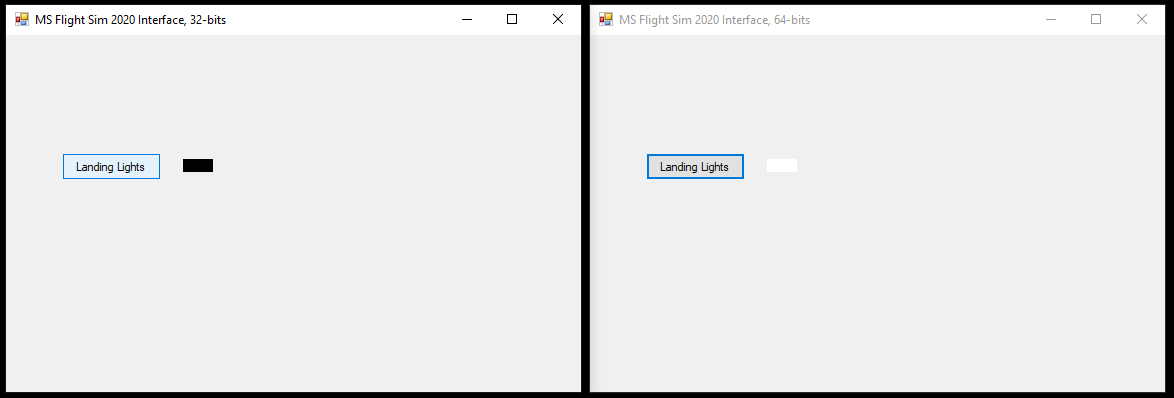

Step 1, made 2 identical programs in 32 and 64 bits, that turn the light ON/OFF only on their side.
Attachment 9416
Step 2, get them to turn ON/OFF both sides.
... insert cool pic here on soonday ...

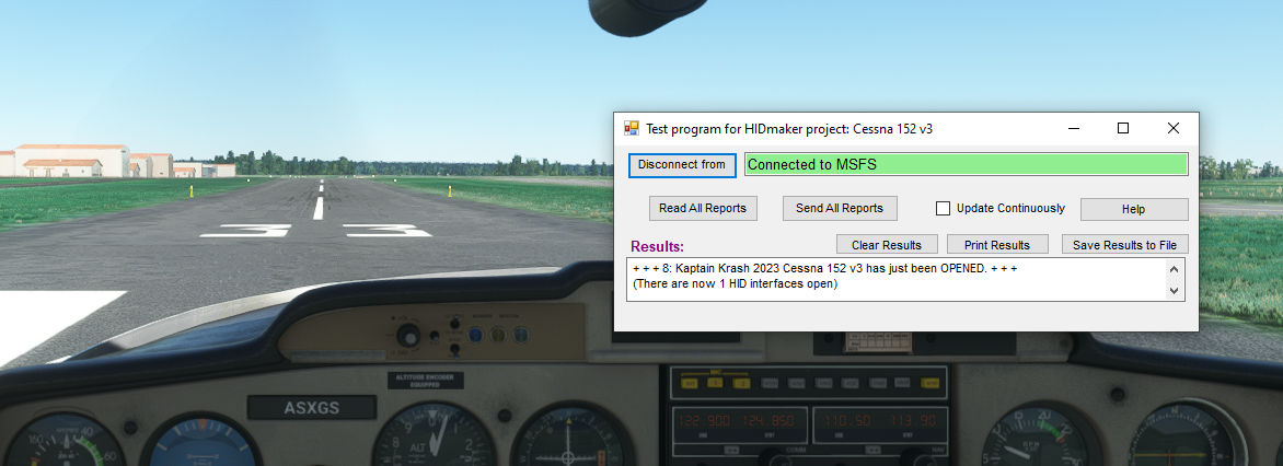

Note to future-self, ALWAYS put the Windows INCLUDE at the top of the list. Argh, the multitude of insane errors and hours of google searches...
Status of the day; didn't get as far as I planned with that stupid include problem, but I did get to compile the generated code with USB components in 64-bits, and connect to MSFS, that last part was my do-or-die moment of the day. :D
Attachment 9417
EDIT: Oh yeah, the single button in the interface works fine; changing between a 0 and a 1 when I press a button on the Lab-X1. Haven't implemented anything else yet.

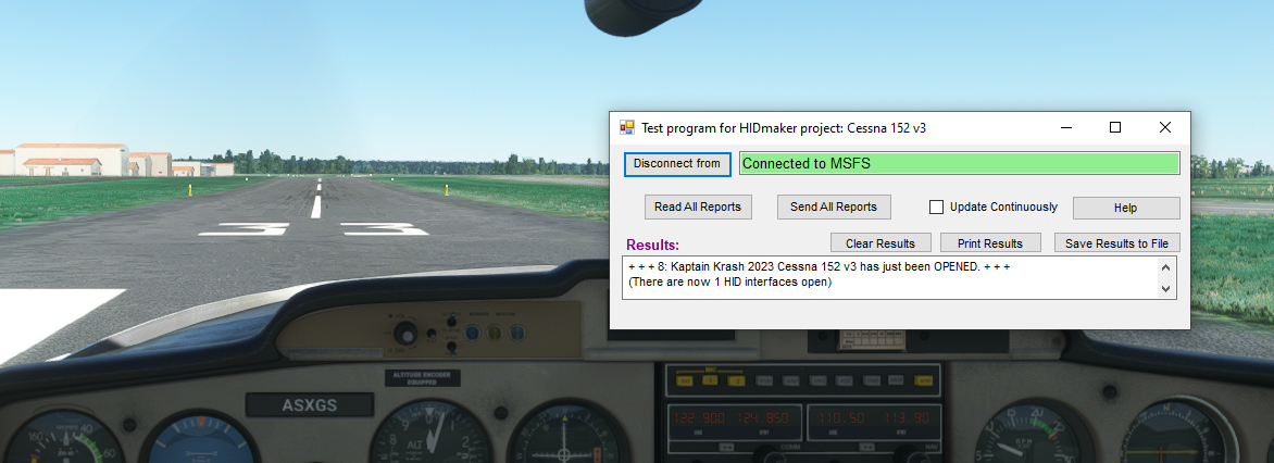

Landing light ON-OFF from the Lab-X1 via USB.
Attachment 9418

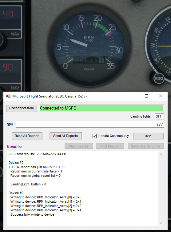

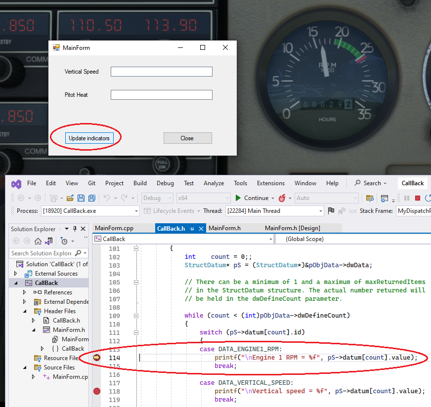

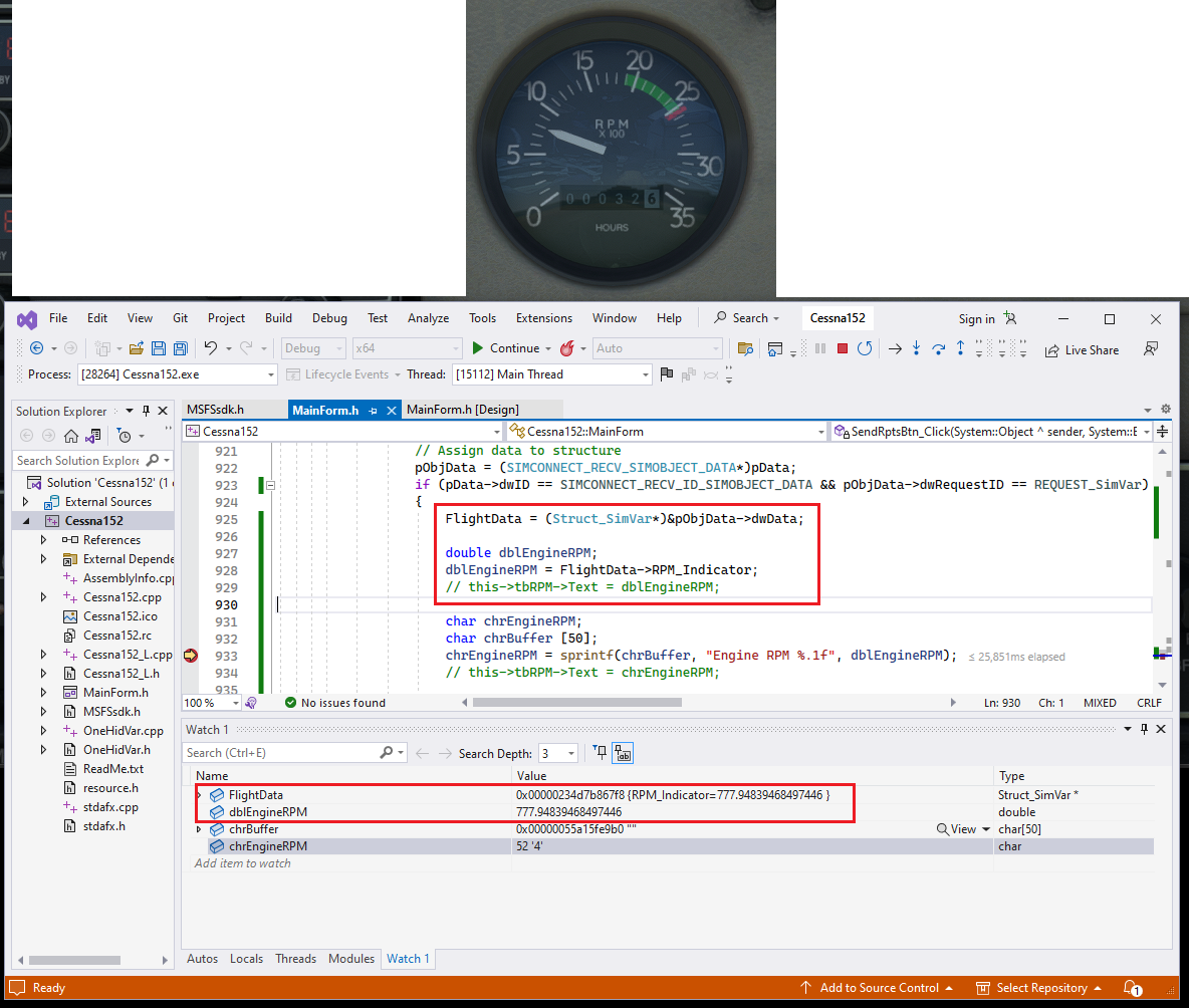

YAY! I can finally detect a change in Engine RPM. And this is why I absolutely wanted to have Code Debugging working.
Attachment 9419
Now I just have to learn how to use structures and variables in C++. :D I kept trying to peek at that data, but I just couldn't get to see anything meaningful.
Good thing we have google tutorials. Worse case, I'll ask on the Dev forums, but I want to try to get there on my own.

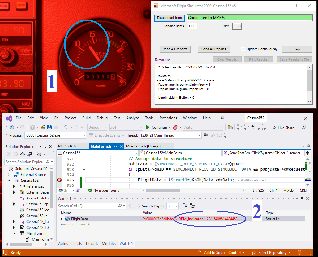

Attachment 9421
I'm so close, I can see the data in the structure and it matches what's displayed on the instrument panel. I guess I'm off to "C++ structure tutorials" in hope of finding something useful.

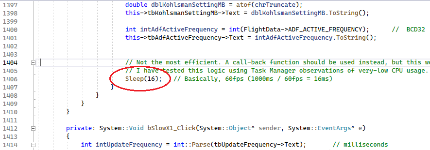

Now I have to return that value to the PIC, but in the meantime, I'm getting a beer.
EDIT: Hmmm, maybe I don't deserve that beer yet. There's a 15 second lag before throttle changes are reflected in my app. I'm hoping it's because I used "option 2" on how you can poll SimConnect for variables; it also contains the USB code (not sure yet if that can impact the SimConnect logic).
Really hoping "option 1" works as promised by the Devs (it's a callback routine, not my type of code, but hey, if it works as promised).

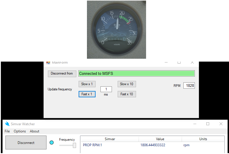

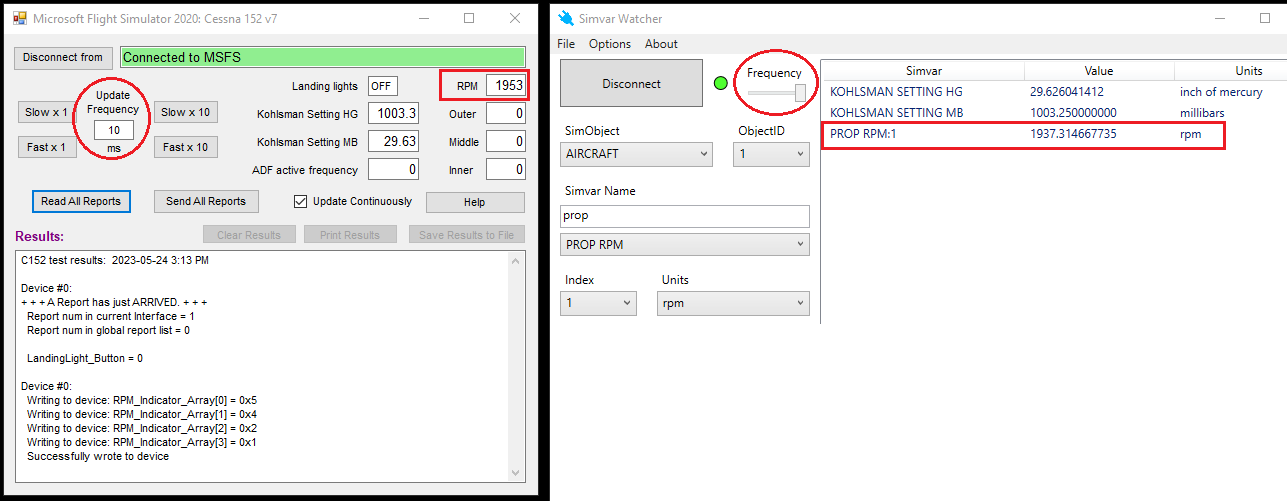

I had a serious lag issue with my USB generated code when I'd read variables from the MSFS SDK. So I started a new program from scratch, no USB, made just to read the Engine RPM and nothing else. Then I compared it with SimVar Watcher; it's the tool distributed along with the SDK to doublecheck our work. Turns out I had to add a delay feature to run beside SVW at full speed (I got extra practice on string manipulations and tweaking a Timer on the fly, so not a waste of time).
This is with a 1ms delay timer on my program during max acceleration:
Attachment 9424
I had to slow down to 5ms to be right at the same speed as SVW also during max accel:
Attachment 9425
So I'm happy. At least I know that now I can run at an acceptable rate of speed. I have a theory why my code bogged down before, need to do another test.

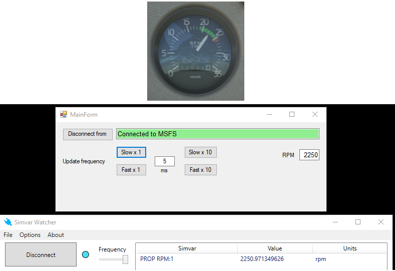

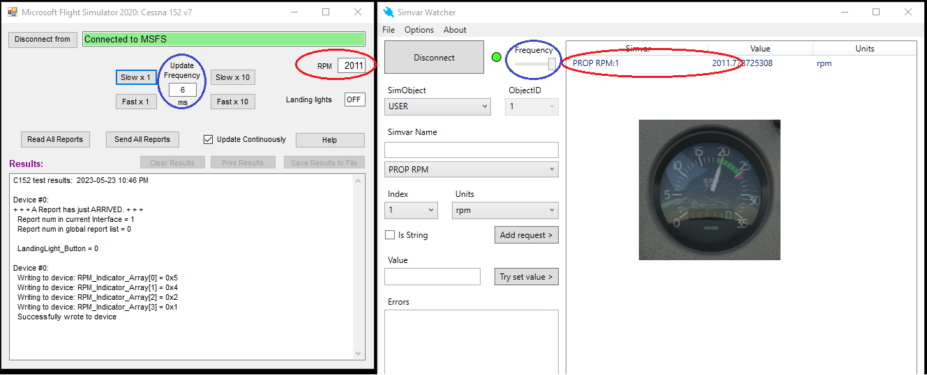

Hot diggity dog! It's even better than I thought under real conditions.
I could slow my program to 6ms even after adding USB and I'm still updating as fast as SimVar Watcher.
Attachment 9426
Problem was simple. I was piggy-backing my reads to the MSFS SDK on top of the USB Timer. I added a separate Timer (like I practiced in the previous post), and away it went.

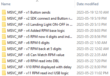

Not bad considering 4 days ago I was "pushing a button".
Attachment 9427

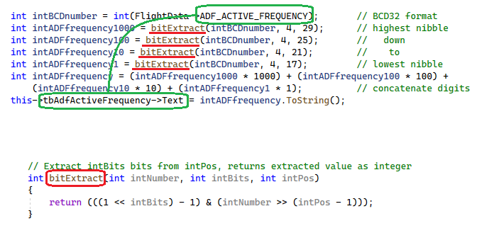

2 Attachment(s)

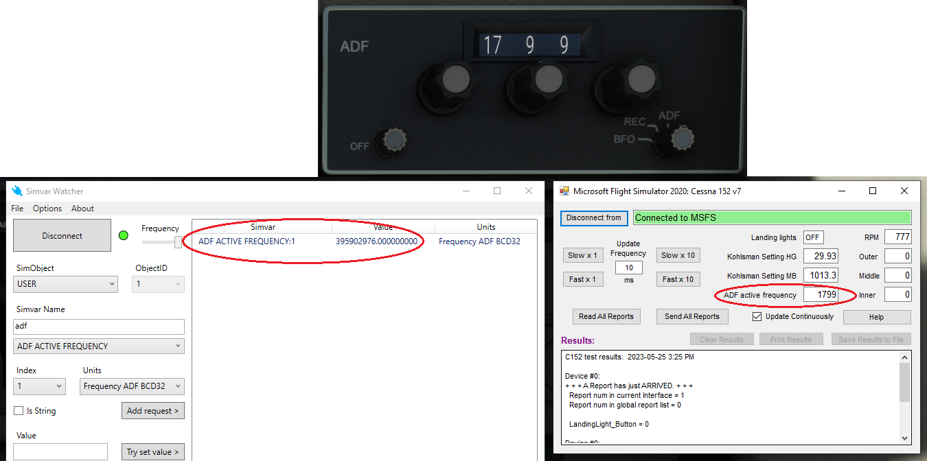

One possible issue has been bugging me for a few days; my SimVar tests were all done with only a single variable. I wasn't sure if the code I was using could support multiple variables.
Added the markers and both Kohlsman settings; the ADF frequency still isn't completely converted (gotta play with BCD, never done that), and bumped up my delay to 10ms. I'm still faster than SimVar Watcher under full throttle acceleration.

3 Attachment(s)
I spent the day fleshing out the Form with all the variables to be Read from Flight Sim on the left, and all the controls to be sent up from the PIC on the right. I run SimVar Watcher just to be sure I'm still on par on engine RPM reads during full throttle acceleration.
There's no added logic behind these new fields, it's just typing them in, lining them up in a meaningful manner, and compiling to make sure there's no serious typos. These fields aren't meant to stay visible; I'm gonna hide them once development is finished. I'd rather have them in the background ready to be reactivated if I have problems. The only thing expected to remain visible is that "Connect to Flight Sim" button and textbox.
Attachment 9430
I did get to finish the conversion technique on that darned ADF Frequency earlier today. Check the number displayed at the top on the instrument panel, then compare it to the number stored in Flight Sim on the left. :D I did BinaryCodedDecimal conversions back in college; that was in late 70ies, never touched that since. LOL
Attachment 9431
Nothing spectacular, got the bottom subroutine off google, figured out all the BCD32 manipulations after 1 good video on nibbles.
Attachment 9432
I keep thinking the worst is behind me; and then another day starts.
