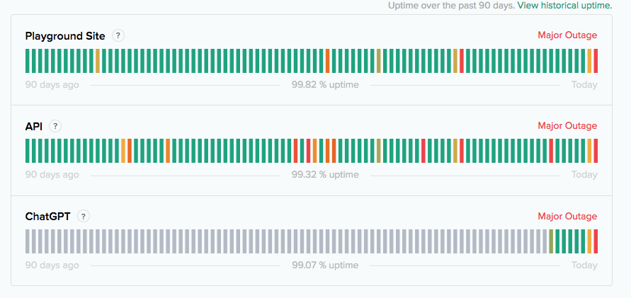

So, this morning im putting together a cron job and bash script to automate the weekly tidy up one of my servers.
I turn to GPT for assistance and ITS DOWN !!!!
Update - We are continuing to work on recovering services.
Feb 21, 2023 - 00:52 PST
Identified - We have identified the root cause and are working to recover service.
Feb 20, 2023 - 23:59 PST
Investigating - We are currently investigating an outage affecting all models, including ChatGPT and Playground, beginning around 11:05 pm Pacific.
Attachment 9331
Feb 20, 2023 - 23:40 PST
