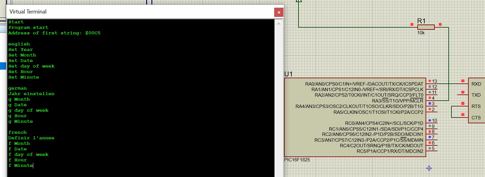

and it is , i "fancied up" my code a bit and can change language with one var
Attachment 9131
mikes suggestion would be useful to allow a common set of string messages to read into hef in chosen language from a
pg-flash coded larger multi-lingual data set.
its all doable
