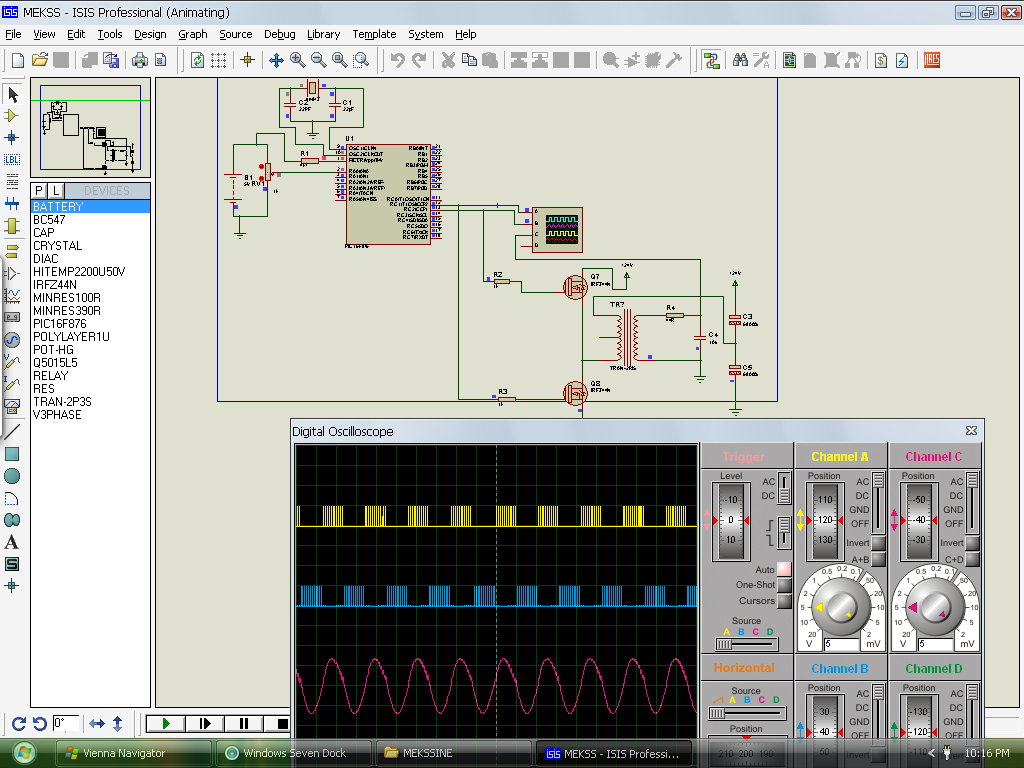

Push Pull to Half Bridged Sinewave Inverter
Here is my first attempt at Sinewave inverter.
This is the Proteus simulation and code:
Attachment 8344
