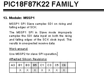

BE aware of new bug found for these chips using the slave hardware spi port 1 (MSSP1) on these chips ,
i reported issues some months back to microchip , looks like there was more to it
snipit from latest errata
Attachment 8313
