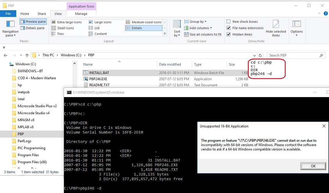

I started by copying the installation EXE into a new PBP folder on C, just like the BAT file does. Then tried WinXP, Vista and Win7 compatibility as Administrator and keep getting this error:
Attachment 8159
I don't get it, I installed on my 64-bit gamer without problems a few years ago. Any ideas?

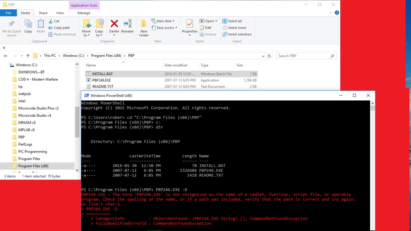

Opened X86 DOS window, manually did same commands as the INSTALL.BAT that came along with PBP v2.46 CD and it doesn't decompress as expected.
Attachment 8160
Even set PBP246.EXE to run as ADMIN, tried both Win7 and Win XP sp2.

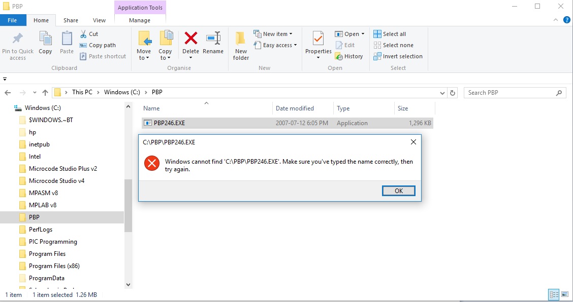

Recopied all my stuff back from CD into c:\PBP folder, editted INSTALL.BAT with new names, and same sort of error.
Attachment 8161
I really wanted to figure this out but I'm about to give up and just get PBP v3 Gold and be done with it.

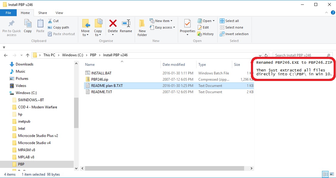

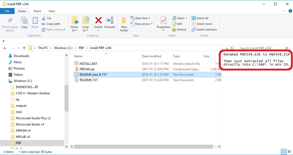

The README kept mentionning "files being uncompressed", so I renamed the file to PBP246.ZIP,
and VOILA! It unzipped all files as expected. Just gotta test to make sure things are all ok, but everything looks fine.
Attachment 8162
EDIT: PBP v2.46 patched and updated to v2.60c without problems.
