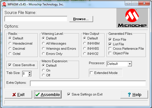

You can see which version of MPASM you're using in the progress window during the assembly process:Quote:
I don't know where I can see the version of MPASM.
Attachment 8090
If, for some reason you don't see that you can always start the MPASM GUI application (MPASMWIN.exe) in the MPASM installation folder and see it there:
Attachment 8091
