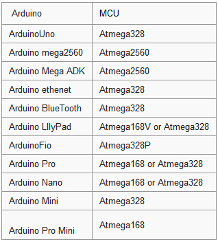

Great Cow BASIC is an open-source BASIC compiler for Microchip PIC microcontrollers,
It's compiles for most 10/12/16/18 series PIC controllers.
But there are no PIC MCU in the Arduino MCU list.
Attachment 7432
Re: Can MCSPX be used with Arduinos?
No, there's no PIC on any Arduino but there are (a boatload of) ATMEL chips on Great Cow Basics list of suported chips.
So, apparently Great Cow BASIC can be used with the Arduinos but to answer Hylans original question, no, PBP can't compile code for an Arduino (ATMEL MCU).
