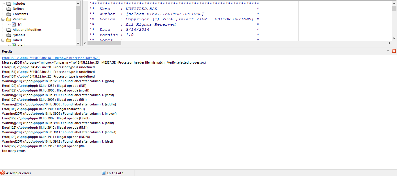

| i just buy a PIC18f45k22 using a microcode@PBP programmer to load my hex to my pic. But im having a problem with my compiler with is a MPASM . Here is the erro generated by the compiler as i drag and drop the alter.asm file |
Error[132] c:\pbp\18f45k22.inc 18 : Unknown Processor(18f45k22)
messange[301] c:\progra~1\microc~1\mpasm~1\p18f45k22.inc 33 : MESSAGE: (Processor-header file mismatch. Verify selected processor.)
Error[131] c:\pbp\18f45k22.inc 20: processor type is undefined
Error[131] c:\pbp\18f45k22.inc 21: processor type is undefined
Error[131] c:\pbp\18f45k22.inc 22: processor type is undefined
Warning[207] c:\pbp\pbppic18.lib 1237 : Found label column 1.(goto)
Error[122] c:\pbp\pbppic18.lib 1237 : Illigal opcode (INIT)
Error[122] c:\pbp\pbppic18.lib 3906 : Illigal opcode (movff)
Warning[207] c:\pbp\pbppic18.lib 3907 : Found label after column 1.(movf)
Error[122] c:\pbp\pbppic18.lib 3907 : Illigal opcode (RR1)
Warning[207] c:\pbp\pbppic18.lib 3908 : Found label after column 1.(addlw)
Error[122] c:\pbp\pbppic18.lib 3908 : Illigal character (1)
Warning[207] c:\pbp\pbppic18.lib 3909 : Found label after column 1.(movwf)
Error[122] c:\pbp\pbppic18.lib 3909 : Illigal opcode (FSR0L)
Warning[207] c:\pbp\pbppic18.lib 3910 : Found label after column 1.(comf)
Error[122] c:\pbp\pbppic18.lib 3910 : Illigal opcode (RM1)
Warning[207] c:\pbp\pbppic18.lib 3911 : Found label after column 1.(andwf)
Error[122] c:\pbp\pbppic18.lib 3911 : Illigal opcode (INDF0)
Warning[207] c:\pbp\pbppic18.lib 3912 : Found label after column 1.(decf)
Error[122] c:\pbp\pbppic18.lib 3912 : Illigal opcode (R0)
too many errors
Can anybody help me in solving the header file problem...thx

im using PIC PRO BASIC version 2.60 and MPASM version 8.15.

And this the error i got after compile the code
Attachment 7414
Hope you can give feedback as soon as possible :D
