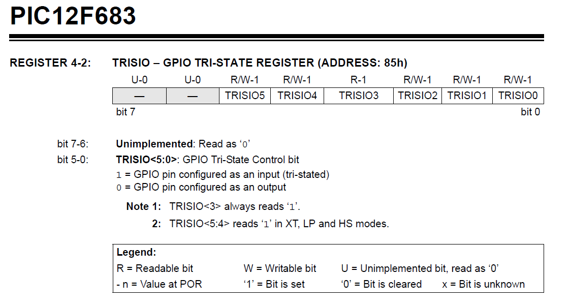

Attachment 7411
Even though the data sheet says POR is input I ALWAYS set in code.
