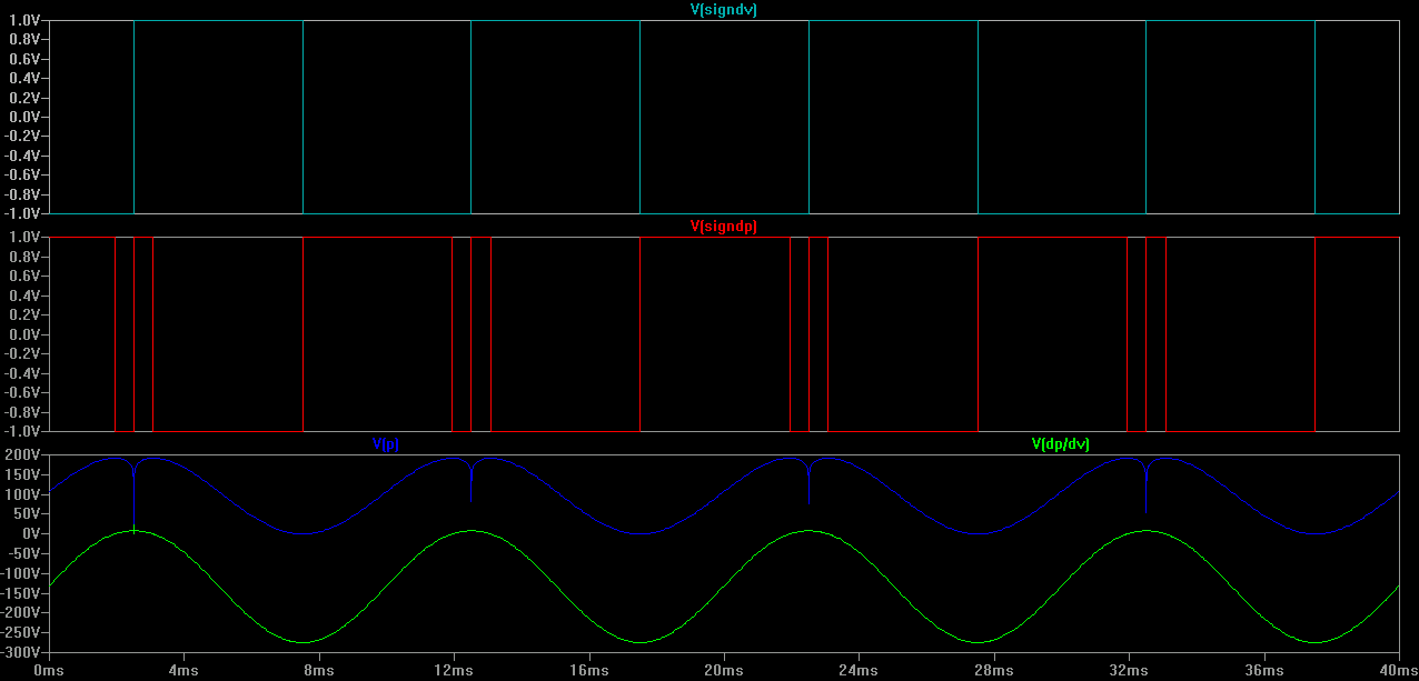

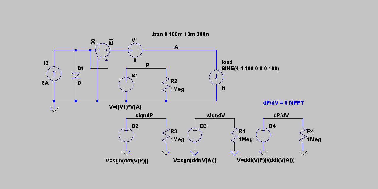

2 Attachment(s)
Re: MPPT solar battery charger
Hi iw,
I'm impressed of your work.
I played once with mppt converters and i know how crazy is.
the attachments show dc simulation of 21V@8A photovoltaic. May be will be useful for you. I have dozens simulations of buck, boost and sepic converters, but i didn't finish the work because the 'client' give up. Now i have 3kg prototype but no panel to play :(
Allow me to ask you what mppt algorithm you use ?
Some of them are:
* perturb and observe (P&O - sign dP)
* incremental conductance (dP/dV=0)
* constant voltage or current (CV,CI)
May be i'm too lazy to read all your code and find out, sorry.
I suggest reading of this:
Comparative Study of
Maximum Power Point
Tracking Algorithms
D. P. Hohm and M. E. Ropp*,y
Electrical Engineering Department, South Dakota State University, Brookings, SD 5700-2220, USA
It helps me a lot, amazing study.

I suppose the first chart explains your code. I found it in the net. But i'm still out of focus.
Why is the measurement of dV? As is shown on the simulation, the voltage of the panel
is almost constant up to 90% of available current. So there is "constant voltage" and "constant current" methods. The voltage remain the same even at night, of course with almost no load. The photons flow become electrons flow, i.e. available current. So the panel is kind of current generator.
And of course, measured dV will be small and inaccurate, may be the noise is from there.
I used hardware circuit similar as algorithm in second chart. So i'm interested of your work. I will try to find my circuits, but unfortunately they are on almost dead HDD ...
2 Attachment(s)
ok, i answered myself. I did simulation again.
The voltage have little change indeed and can be used to determine the direction of duty. But this can be done without this too.
Iw, if i find some time i will make Proteus simulation with your code.
Will be nice to check some other algorithms before the fire of soldering iron :)
Attachment 7340Attachment 7341
PS I don't know how to resize the images, sorry
