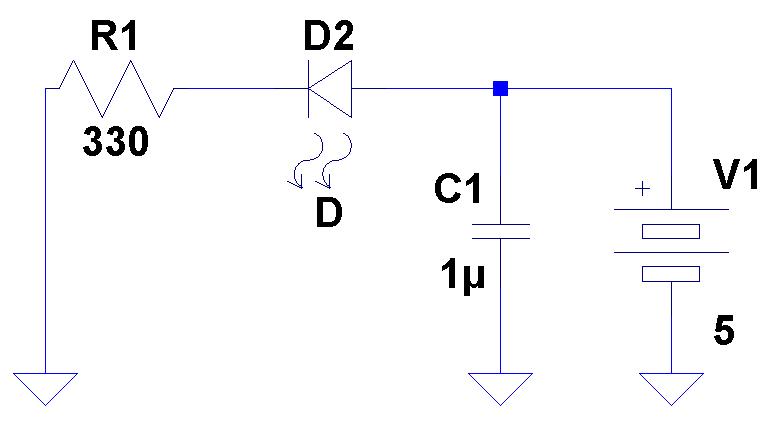

Do any of you use LT Spice to run simulations at a basic level?
Attachment 7261
I can't afford the fancy pro stuff so I'm looking for a substitute. I'm noticing that a lot of the tutorials are aimed at those that know what they're doing already. :D

I'm still looking for a switch. I saw a voltage-controlled and current-controlled switch, whatever that is, but no momentary on pushbutton, toggle, rocker or anything of the sort.
I did see the panel where I enter a duration, also saw that we get voltage/current probes pop up at appropriate places. But that's it, I'm really hoping this can be used at our level 'cause Proteus is just out of my reach.
I'm gonnna go through that first chapter again, put in whatever values they say to use and see how it goes. Then slowly adapt for my use. One problem I see right away is the lack of PICs, if I have to manually enter those in, that's going to be overwhelming. I might as well build the breadboard, it'll take less time for me than to tell Spice the properties of all the pins.
I'm afraid this will be for discrete components only and I never do those. Too bad Microchip doesn't distribute a Spice library.
