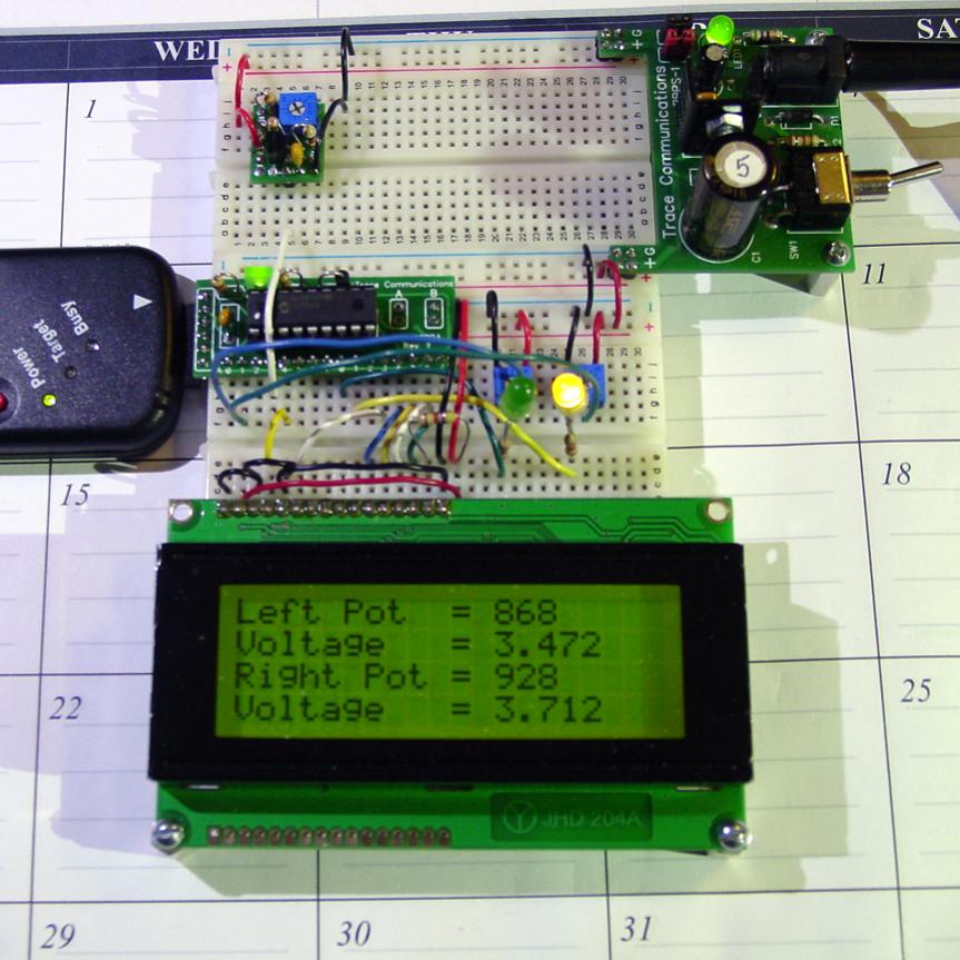

Thanks for the reply. Here's the way I am doing it now, but it seems there should be a simpler way.
Here's a picture of the LCD with the above displayed.Code:' Program Code:

Thanks. That is the information I needed. I haven't yet figured out how to insert a decimal point in it, but maybe that will be possible.

Here's my code; it works. Thanks.
ETA: I am using a 4.096V reference.

Trace Communications, I knew I saw that somewhere before. :)
I like your power supply PCB above; good idea to have it clip onto a breadboard, tidy and solid. My solution was "el cheapo", just a 5VDC wall adapter with a small electrolyte cap at the end. One day I'm going to either short-circuit the flimsy leads or snap them off.
