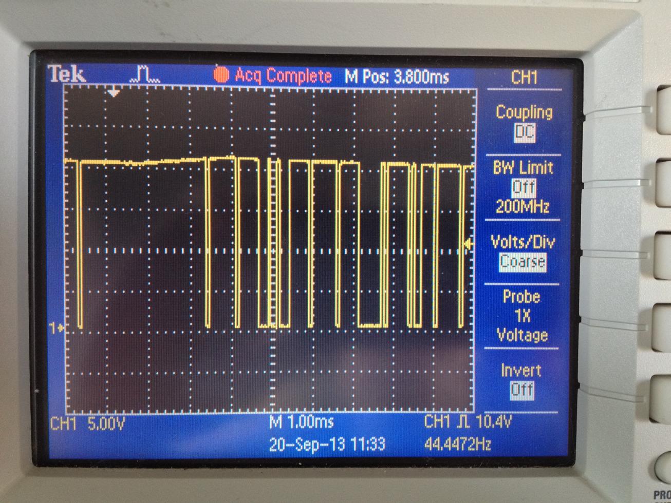

I'm still kind of lost but seem to be making a little progress. I can see that the entire packet takes 20mS to transmit. It's hard to tell where one piece of data ends and the other begins. I can see the data change when I press buttons on the controller but some of the data isn't used for this application. In other words, those bits/bytes are just taking up space but must be included when the packet is transmitted.

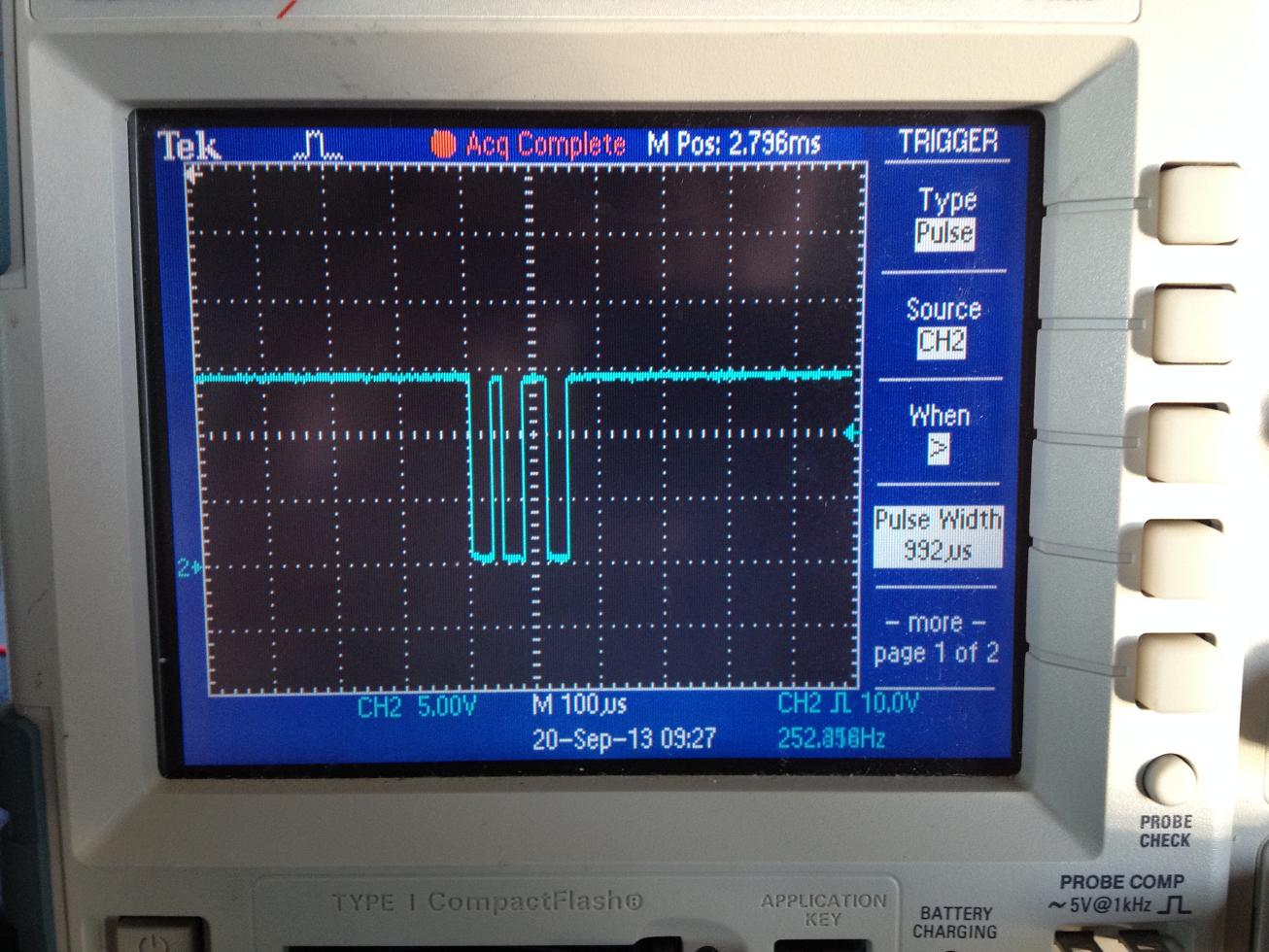

Perhaps this will help you guys help me. I concentrated on the ones digit for the home team score. I think it takes 750uS to transmit the ones digit and I based that assumption on when the edge falls to when it rises again at the end. However, some of the data takes about 500uS. Is it safe to assume that it takes 750uS for a byte and maybe 500uS for a bit?
To duplicate the packet (I'm starting with the ones digit), I have the data from the PIC going to the input of a ULN2003A. On the output side I'm using a 10K pullup and then measuring it with the scope. One problem I'm having is that I can't quite get the timing right. I've attached two pictures that show my problem. The first picture is of the source. I'm trying to duplicate what is seen here. In the middle (-250uS from center to +500uS from center) is the number 2. Attachment 7085
Here is my attempt to make the number 2. As you can see, I had to adjust the sec/div to 100uS and the second pulse in the number two isn't the same as the source.Attachment 7086

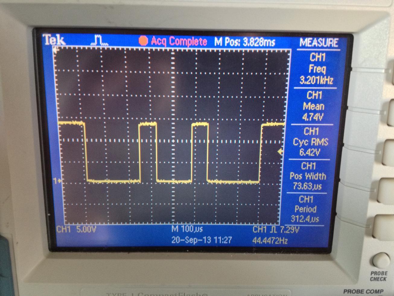

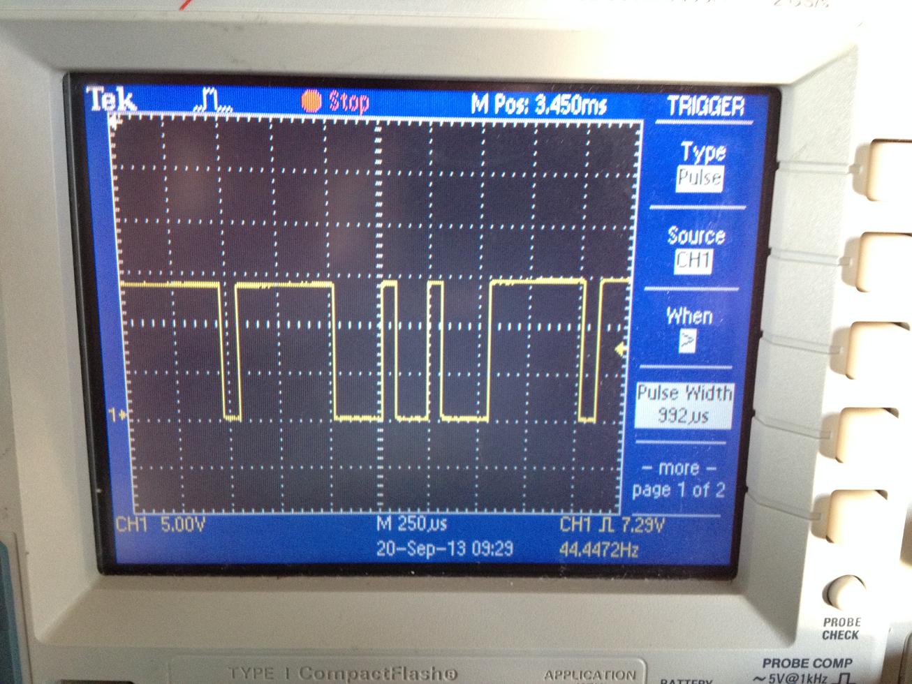

From the images, I do not think it is an UART transmission. Can you zoom out the source capture a little so that you center the '2' and we can see around it a bit more detail?
3 Attachment(s)
Re: How to decode communication

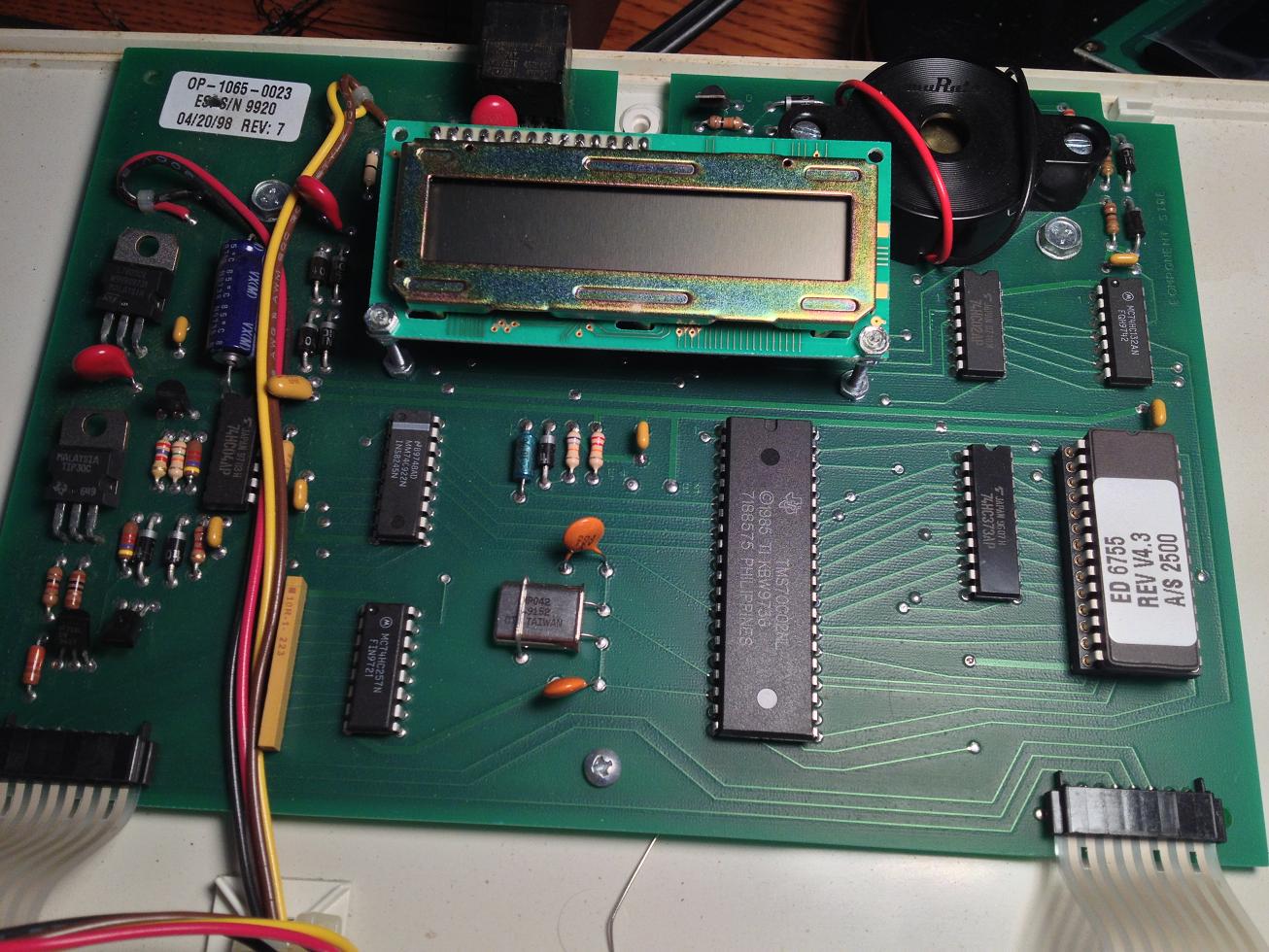

I've attached pictures of the PCB, a picture of the #2 zoomed in and a picture of the #2 zoomed out. Attachment 7087Attachment 7088Attachment 7089
Looking at the components, it might be a current loop signalling. Is it?
Are there any communications related components below the LCD ? Cant see them in the photo.
There's nothing under the LCD. What you see is what you get. Correct me if I'm wrong but it can't be a current loop because I have nothing connected to the output except the scope probe.
The signal output appears to be coming from a 2N3417 (collector), which also appears to be in parallel with a TIP30C (collector).
