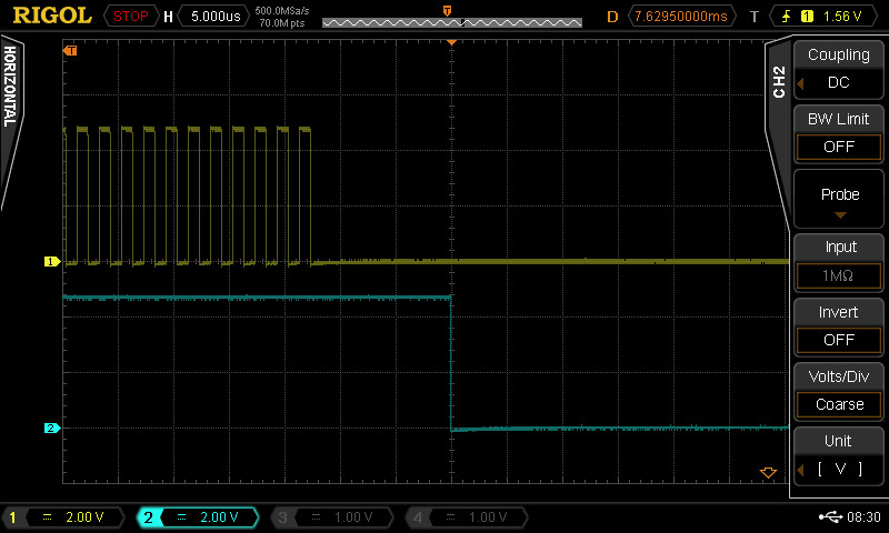

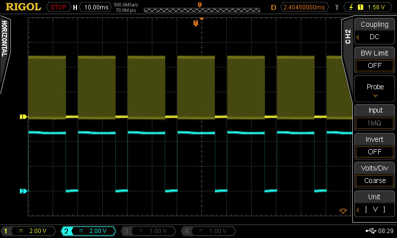

I have a scope screen grab of the output but for some reason the file upload manager on the forum refuses to work, the upload just hangs...aarghh....
Now, if you intend to do other things with the PIC as well then this simple aproach obviously won't work. But you could use a timer interrupt in order to turn on and off the carrier at the correct intervals. I haven't personally used the data signal modulator module in the 12F1840 but it sure sounds like the "correct" way forward. The 12F1840 also allows you to run at 32MHz using the internal oscillator and 4x PLL which would allow you to get higher output frequency using the CCP module than on the 12F683 which tops out at 8MHz.

I'm going to try to add two screen-grabs from the scope. Last time I did the uploader didn't work but hopefully that's fixed by now. Nope the bloody thing still doesn't work, sorry but you'll have to trust me that it does work here.

2 Attachment(s)
Re: Maximum frequency output from a PIC
Hi Nick,
Yes, as long as the loop takes longer to exectute than the period time of the PWM signal (2us in this case) it'll work without additional delay in there. When running at 8MHz each ASM instruction takes 500ns so there's really only time 4 instructions in this case. The Goto Main takes 2 and the jump caused by the IF-THEN takes 2 so that's 4, then we have the rest so it's pretty safe to run it without any delay.
Here are the screenshots I mentioned:
Attachment 7080
Attachment 7081

I just can’t wait to try the code again (that will be in a couple of hours after I get off work).
The signals look really good. Only about 12 uS delay on the falling edge which is better than I need. Is it the same at the rising edge?
Nick
Hi Nick,
Yes and no....
Yes because it's going to be in the same ballpark.
No, because it's not going to be an absolute number (on the rising OR falling edge) because the carrier signal might "come on" (or off) at any time. If it happens to do that just before we check it the delay will be very short, if it happens to do it just after we just checked the delay will be a little longer.
I measured a couple of pulses here.
Delay on rising edge: 10, 7.5, 9.5, 10, 7.5, 6.5 us
Delay on falling edge: 9.5, 11.5, 12, 8, 8, 11 us
So I think you can consider 12us to be around the worst case for this particular code. Would you prefer constant delay at the cost of it being longer? (Not promising anything, just asking).
