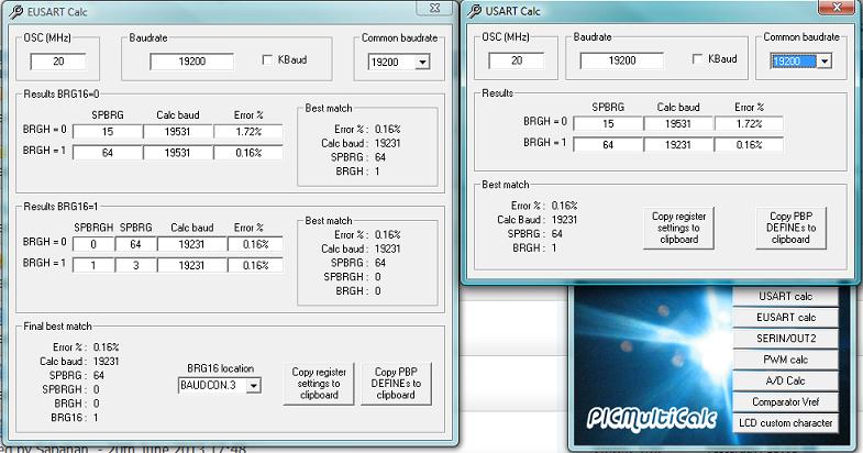

Hi Can someone list the settings here from PICMultiCalc for 20MHz Osc, 16F877A @ 8N1 + 19200 Baud rate please as the calculator is not working on my computer. Thanks

You mean like this?
Attachment 7016
Thanks Louie. Could you please paste the settings here for the USART which I can copy into my code.
Oops, I knew I forgot something...
Code:' Mister E PIC multi-calc "USART calc"
