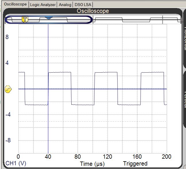

Believe it or not, I replaced the chip and now the pwm is working. (see attached screenshot of scope trace). Yet, all the other sections were working fine, A/D conversion, LCD display, interrupts and timer.
Attachment 7001
Now, I will go back and make it not work to see what codes I don't need and/or do need.
