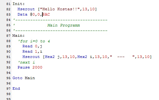

AM i going nuts ?! srly until yesterday EVEYTHING was good. Im doing a project with some Led dot matrix and i need to store some fonts. I used on-chip eeprom of my 18F26K22. I dont know if i did something wrong i can't recall but i can't write on the eeprom. I used an other 18F26K22 but still same results. Is there any specific number of times that you can write on Eeprom ?? I remember that you can write many many many times until it gets destroyed...

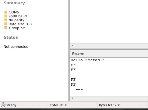

SO i tried to write 2 bytes on the eeprom and recall them to 1 Hserout to check where the problem is. BUT still !!! all data i got back was $FF ....
Doesn't $FF mean eeprom is empty ??

Here is an image from the simply data-read command i tried with an Hserout indicator.
Attachment 6967
Attachment 6966
