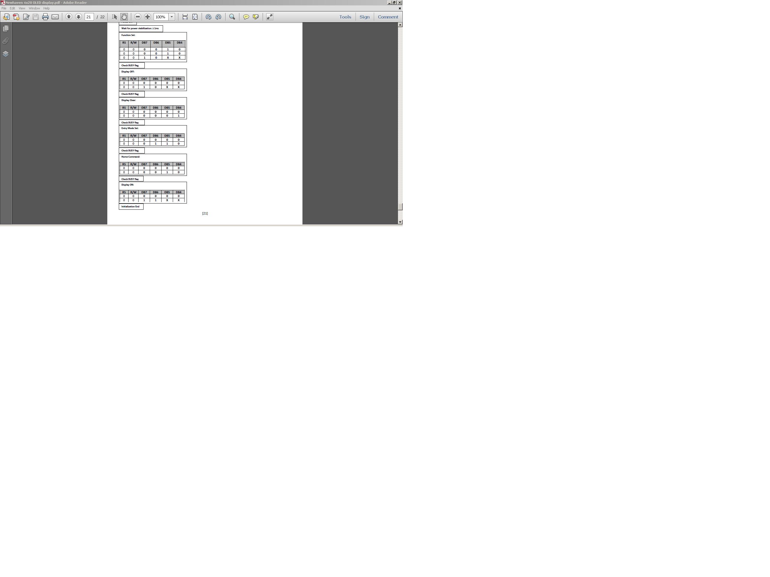

My other question is about how to shut off the OLED screen. According to the datasheet, I need to zero everything out and then pull DB7 high. At least that's that way I think it should be done but it's not working. I'd like to shut off the LCD screen and clear it using the table shown below. Is there anything I'm missing?Attachment 6961

Christopher, On the Newhaven OLED you can use LCDOUT $fe,$08 to turn the OLED off and LCDOUT $fe, $0C to turn it back on, but this will not clear DDRAM. Once turned on again you will still have the same thing on your screen. There may be a better way but in some cases cycling power is the only way I have found to truly clear the screen. A poor, but sometime useful, fix for this problem in some cases is to write blanks to all locations as LCDOUT $fe, 1 doesn’t always work. I have also found that if there is a glitch during a command to the OLED the address gets scrambled and the OLED screen reads gibberish and can only be cleared by cycling power. Some of these problems are discussed on the Newhaven OLED forum. Your table below looks like the initialization routine which PBP is taking care of. I haven’t tried to write my own re-initialization routine for this OLED but I would be surprised if DDRAM would be cleared to give you a blank screen. I hope this is of some help.
Glad I'm not the only one. I was pulling my hair out trying to figure out what I was doing wrong. I notice this problem mostly when the screen is idle (characters sitting on the screen and haven't changed for a while). Is that what you see?
If there isn't a software fix for it, I guess I'll have to use an output from my ULN2003A to take care of the power cycle.
