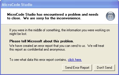

I have Microcode Studio MCSX that came with PBP 3.0. Right from the start there have been consistent problems with MCSX stopping, shutting down, and showing the error message below:
Has anyone had success using MCSX and if so, what is the secret?

I've re-installed PBP3. Now with version 3.0.6.4. Re-installed MCSX to version 5.0.0.5. Both are the very latest as far as I can tell.
The program is still not working. MCSX stops and throws off the same error message as above. It sometimes works for a while, but then goes bad. A cut and paste operation is not tolerated at all.
Any ideas out there? At this point the bugginess makes it impossible to work with.

Ioannis, I found and ran the system file checker. A search disclosed the correct format to be: sfc.exe /scannow. Followed this with a Windows Update. The result is the same: MSCX stops running, coughs out the same error message. I thank you and Henrick for you suggestions, but it appears something is wrong with MCSX.
Re: Problems with MicroCode Studio version MSCX
I can verify the MCSX runs on Win XP Home. I run a VirtualBox with XP Home on my Linux box (PBP3 does not play nice on Linux, but that is another issue). So, as much as I dislike MCSX there is not a problem with it running.
The next time you get the error message, post here what it says it will send to Microsoft. (click on the "click here"). Maybe we will see the problem?

There are two items behind the error message: Error Signature, and from there Error Details. I can't seem to capture the Error Signature. Error Details is a scrolling display, the first page is below: There is a lot of detail as the page scrolls down, but I'm not sure how to display it.

Some I've noticed is this: When the error message comes up I can simply drag the error window out of the way, then continue to work on the program. I'll try that for a while longer and see if the workability continues. Will report later.
