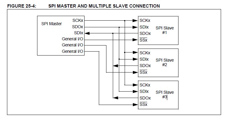

Typical SPI design allows the CLK, SOUT, and SIN signals to be shared between multiple devices. This is because the CS pin is used to determine which part is active on the bus. So the CS pin of each device needs to be a dedicated I/O pin.

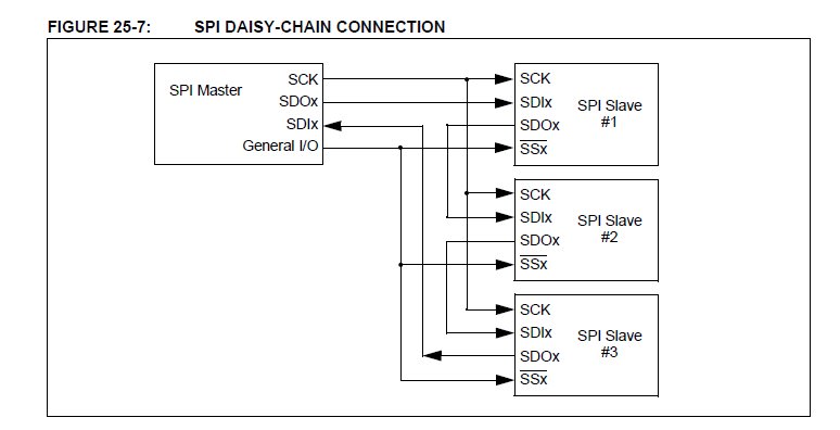

another option depending on your other SPI devices can be a daisy chain
Attachment 6675
but often this is the standard way
