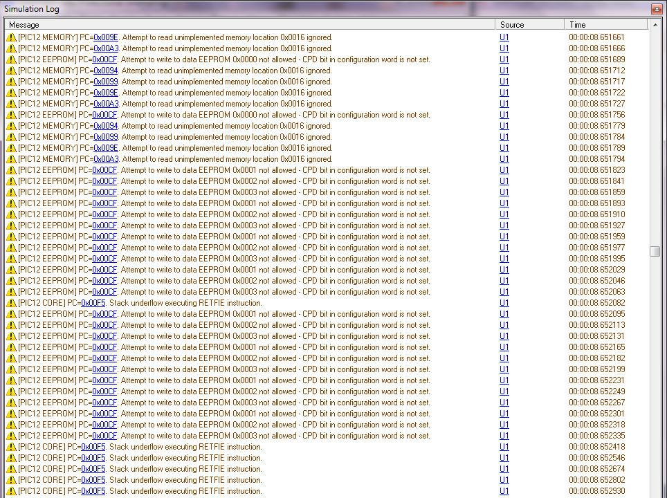

I am not an expert in assembly language so can someone help me please in solving this problem. I am simulating currently in proteus and having stack underflow error when button on PortA.0 is pressed/pulled low. The second error is for writing data to EEPROM location 0. The error says CPD bit in configuration word is not set.
My configuration word in my code is :
__Config _XT_OSC & _WDT_OFF & _PWRTE_ON & _MCLRE_OFF & _BODEN & _CP & _CPD
The following is my ISR routine.
PIC->16F676
There are 4 output pins, PortC.0/3/4/5. The ISR routine is suppose to check if Button on PortA.0 is pressed then if all outputs are low then pull all of them high and if any one of them is high, then pull all of them low and wait for the button to be released. Also write the action taken on the outputs to the eeprom.
The code is also incrementing 4 byte size variables i,j,k,l to reach the value stored in p (which is 150). ISR is for TIMER0 interrupt only.

(Screenshot of errors)
Attachment 6626
