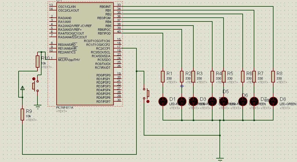

Hi you all:
I am from mexico, and I do apologize for my English, so I am new to programming, as a matter of fact this is my first intent, I have learned reading from posts on this forum and consulting the pbp and proteus manuals, the thing is that I wrote this code on pbp 2.6 and simulated it on proteus and works fine so i programmed the micro controller with masterprog (wich is a programmer that I got from Mercado libre, same than ebay over there) and when I put the micro on the protoboard nothing happened, and when I pressed the reset button and tree leds light up (00101010) and stay on and nothing else, I have tried reprogramming and checked al connections over and over again but noting seems to work, I have read many threads on this forum but I don’t find anything that can help, so I really will appreciate if any one look at the code and comment what I am doing wrong thanks very much in advance.
This is the code

and this is the schematic from proteus
Attachment 6607

Well, you say you're new to programming so why not take a step back and write a few routines to make sure you're LEDs are working properly and connected well?
Your schematic isn't very clear on my screen but it looks like your LEDs are hooked to PORTB. Something like:

Also, I see it worked in Proteus but if the real world LEDs need more voltage/current, looks like a 330ohm current limiting resistor, than 6mA the LEDs may never come on no matter what your programming looks like.
Could you post an updated schematic if none of this helps? Sometimes a second set of eyes helps find problems hidden by the forest.
