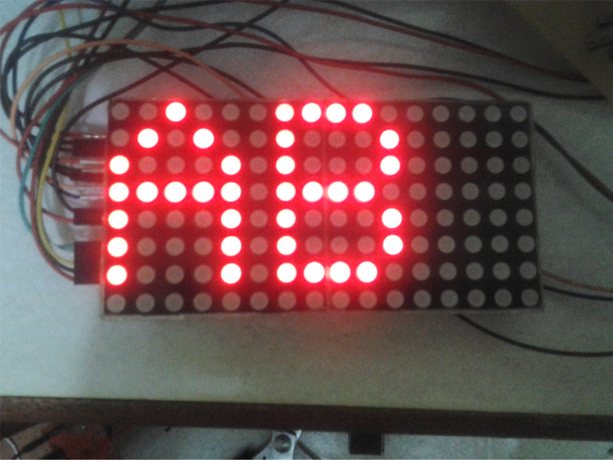

I'm trying to modify font style for the led matrix display(2x 8x8) please image below.
Attachment 6546

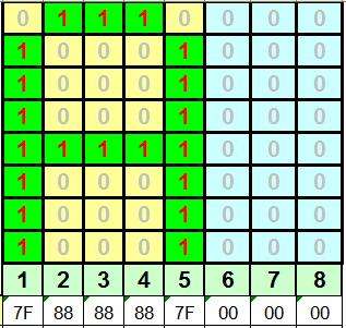

The excel file attached lets you create fonts in dot matrix, and outputs the binary code for each column. Here is a description: http://www.instructables.com/id/LED-...cs-Generator-/
Attachment 6548

Hello, I'm back...I understand how to make the text message stop and scroll forward... can any one point out how can I make it scroll up.
Bellow is the code I'm using...

Thanks again for the update...but sorry to bother you with this again, my text is scrolling downward at pauseus 200(fast) but in a certain point I want to pause it for about a 1 sec before it continue its process again.
Attachment 6560
I tried to place pause within the program but not the exact output I'm trying to achieve...hope there is a way to do this.

Thanks for taking the time helping...
regards,
tacbanon
Re: Customizing font style for running message... Dot matrix editor
I can't test it out here, but I suspect that the problem with the longer pause is that the matrix wasn't being refreshed. So I modified a couple of things to control the flow of the program a little.
I made a "Main_Loop" inside of which "gonder" is called as a GOSUB and the scrolling is controlled with a GOSUB to "kaydir". So both of those sections of code now terminate in a RETURN.
This allows for the modified pause control. As you can see, the longer pause is multiple short pauses with a call to "gonder" in between to keep the display refreshed.
Hope this helps.
Hello SteveB,
Your'e awesome...works great as you expected. :D
I will build to extend the length of led matrix display and post here the results.
