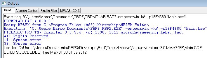

Re: PB3, which error is it ?
Look at lines 12 and 39 in your program.
There is nothing of wrong or strange at those lines and the program is compiled without errors
Attachment 6444
I'm confused, I can't understand. This is not a new program, I use it since some years. The only difference is that I have recentrly upgrade to PBP3. I have never seen this errors before.

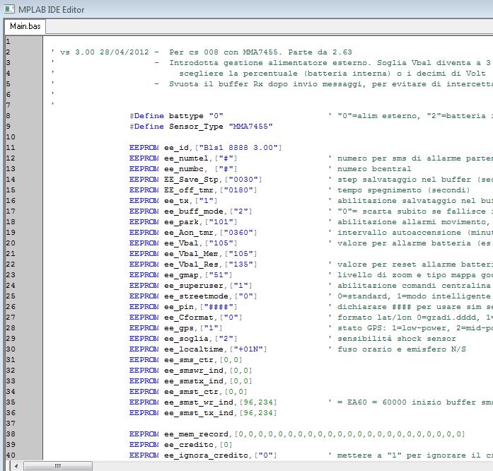

Please post the first 40 lines of your code.
Guessing a former label that is now a reserved word. Look at page 301 of the manual.
2 Attachment(s)
These are the first lines of the code. I can't see any reserved word.
Attachment 6446
Attachment 6447

Please note that thought a syntax error is reported at line 11, the EEPROM at address ee_id is correctly programmed with "Bls1 8888 3.00"
All of your EEPROM statements are incorrect.
You would have to create each of the locations (ee_id, ee_numtel ,ee_numbc etc.) as constants before the EEPROM statements.
If you are expecting PBP to assign the locations to those labels, you would need to use the DATA statements instead.
yes Darrel, all of those are declared constant in another include file, ee_id CON 0 ee_numtel CON 20 etc.
Check the date of the .asm file.
I don't think PBP is finishing compiling the program, and what is getting assembled is an OLD asm file.
If you have the constants in an include file, that file must be included BEFORE your EEPROM statements.
Your program listing above does not do that.
Yes, I don't know why but I realize I have the include file just after all EEPROM statements.
Moving it before, the two errors disappears ..
Anyway I ensure you that also with the include after, the program is compiled, it runs and the EEPROM content correspond to what I wrote in the code. I use this part of code since many years.
PBP 2.xx never reported the error, I see it just now with PBP3.
But I agree that BEFORE is correct, not after ...
