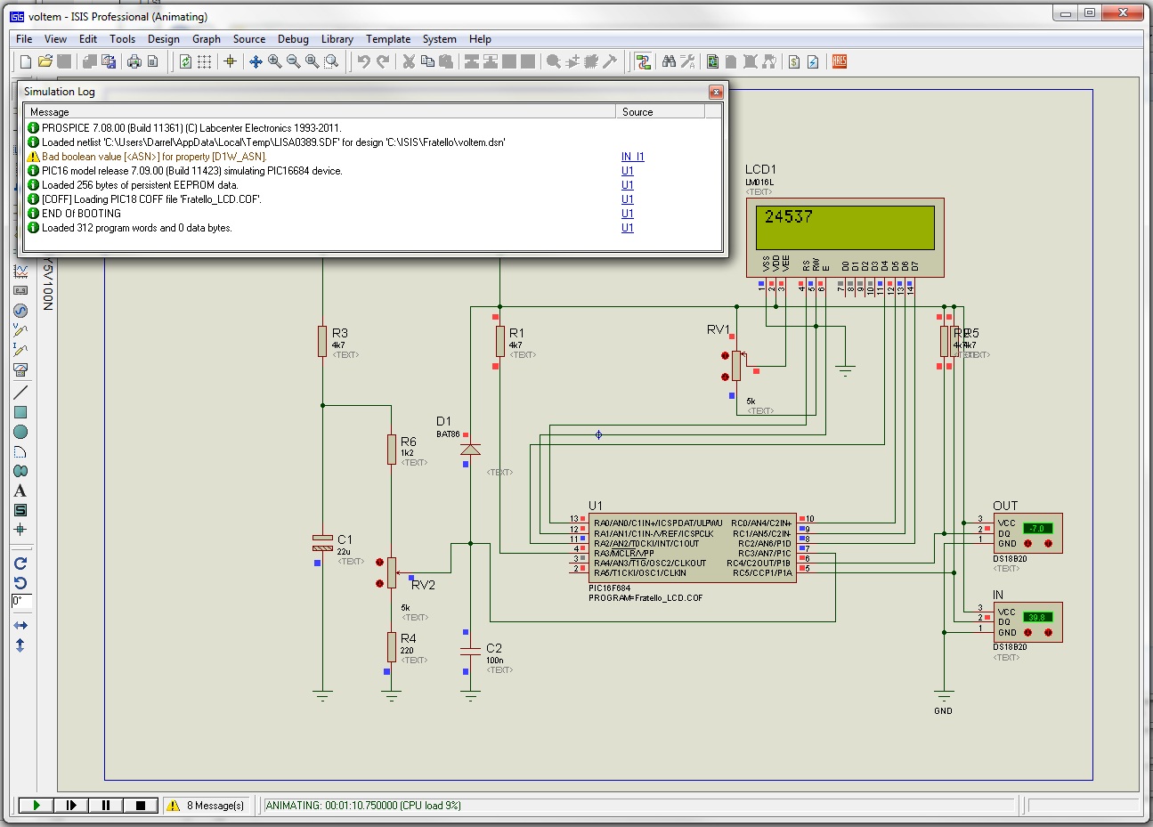

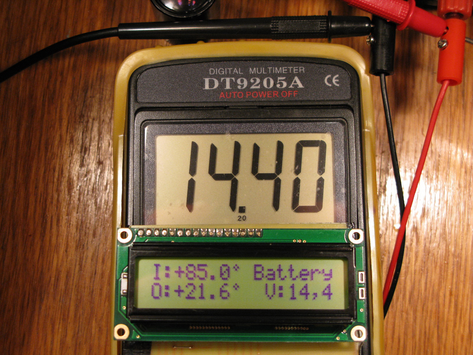

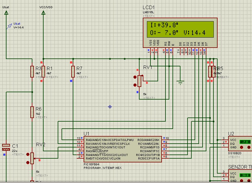

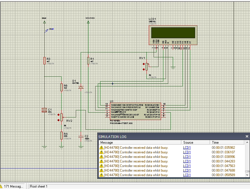

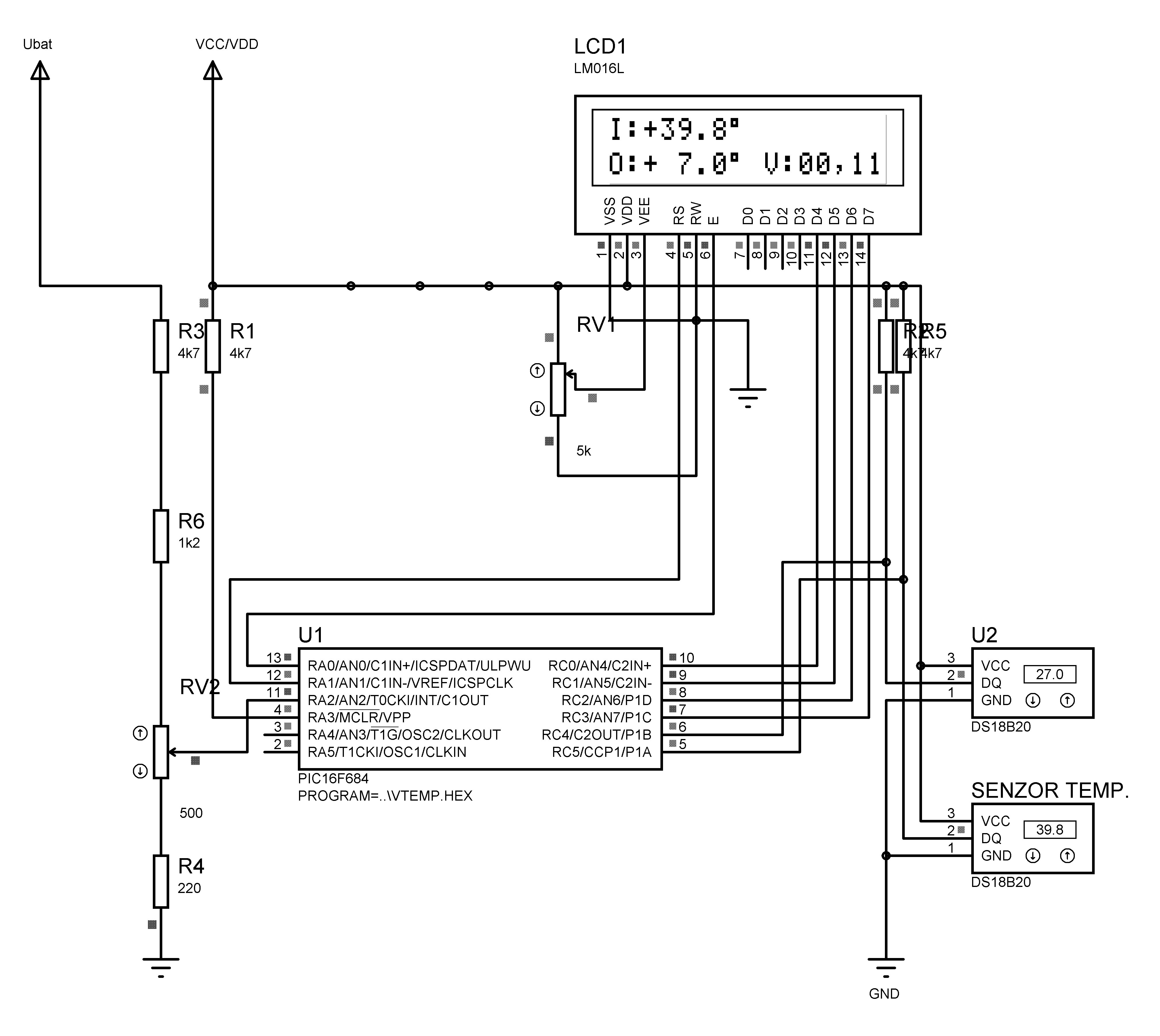

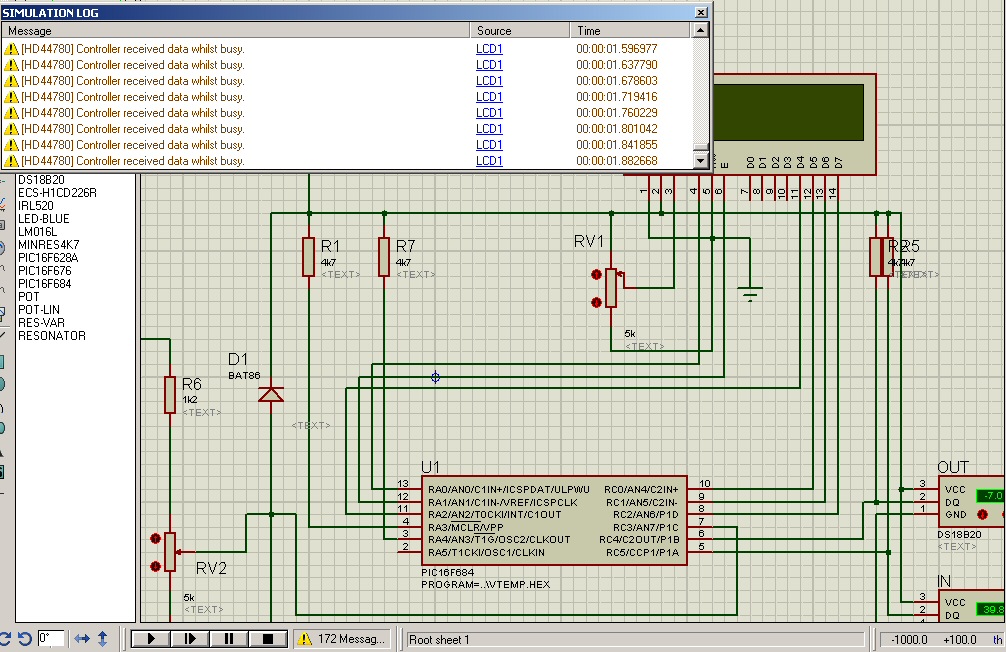

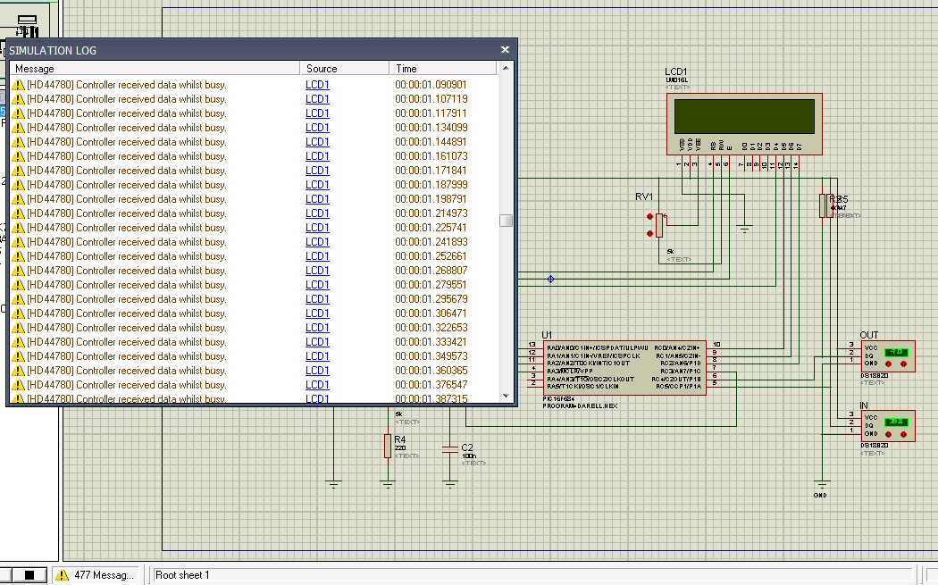

I try to build one thermo-volt-meter for using in my car. I wrote the code, based on my (working) previous experiences with DS18B20 and the great example of Mr.Gioppy (SerVolt). But...the result are ...strange : despite Ubat = 16 Volts, on display the value is 0.02, alternating with 0.22 ?!?
Maybe a sharp mind will find my mistake(s). Thanks in advance !!!
