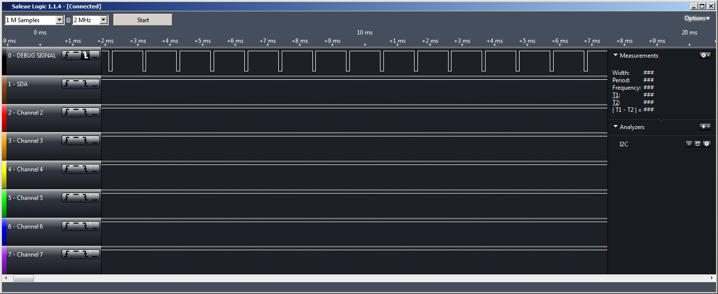

Debug is really a lot better than I thought. Unfortunately, I don't have a 12F running at 8Mhz. All I have is an 18F8723 running at 40Mhz.Attachment 6040
I sent out $FF in a loop. Note that there is virtually no extra space between ANY of the bits. So DEBUG is very fast. But remember that DEBUG is a blocking command. If all you have to do is pull bytes out of an array and send them, you will see the same results I do, but if you have to calculate or use some logic between sending bytes, that will add a bit of time.
