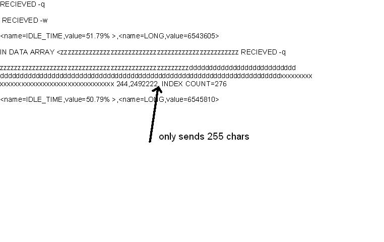

HI,
The manual says long arrays for 18F's are ok,
but my index does not seem to go past 255.
RCVdata var byte [750]
InDX var WORD 'index variable
for ax=1 to indx 'SEND ALL IN MEM BY INDEX
DAT = RCVDATA[AX]
hserout[DAT]
next ax
HSEROUT [", INDEX COUNT=" , DEC INDX ,10,13]
do I have to make seperate arrays if > 255 in PBP.
Attachment 5811hyperterm
thanks

Don,
What size is the ax variable?
It needs to be a WORD too.
Re: Array[750]
Thanks Mr T, certainly works fine now.
