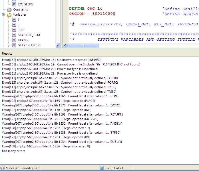

Now, in my other PC where I have PBP 2.60c and MPASM v8.15 I get a bunch of errors when compiling.
Attachment 5746
I assume that the cause of the errors might be the older version of MPASM, but I'm not sure if this is the cause. I checked for the file 16f1939.inc and it is in the directory where it's supposed to be. Any ideas what might be wrong?

The first error states "c:\pbp2-60\16f1939.inc 18 : Unknown processor (16F1939)", so I checked in the PBP directory. I wasn't aware that there was another 16f1939.inc file in the MPASM Suite directory.

I checked in the computer with MPASM v8.15 and the file was not there. However, the file exist in the computer that has MPASM v8.60. Do you think it would work if I transfer that file over to my other computer?

I recommend you download and install the newer version of MPLAB for full support for new PIC types.
There are more support files required than just the P16F1939.INC file.

You can compile all previous PICBasic Pro version with the same version of MPASM. Download latest MPLAB, and set MCS to use MPASM in
Program File \Microchip\MPASM Suite
Then just specify which PBP version you want to use to compile... you're done. MPASM has next to none to do with PICBASIC PRO version.... but New PIC support.
