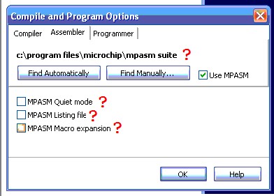

I was going to give DT instant interrupts a test drive... but I see over on his web site that you MUST be using MPASM. I use Microcode Studio and when I went to change the assembler... It did not "Find Automatically", I tried to "Find Manually" but I can't get it to work... also there are several checkboxes that I am unsure of the best choice.

To use MPASM you have to install MPLAB.
Reason to use... for things like DT's interrupts and 18F chips.
Works with MCS and FineLine.
MPASM is all that I use.

I did get MPASM working.
