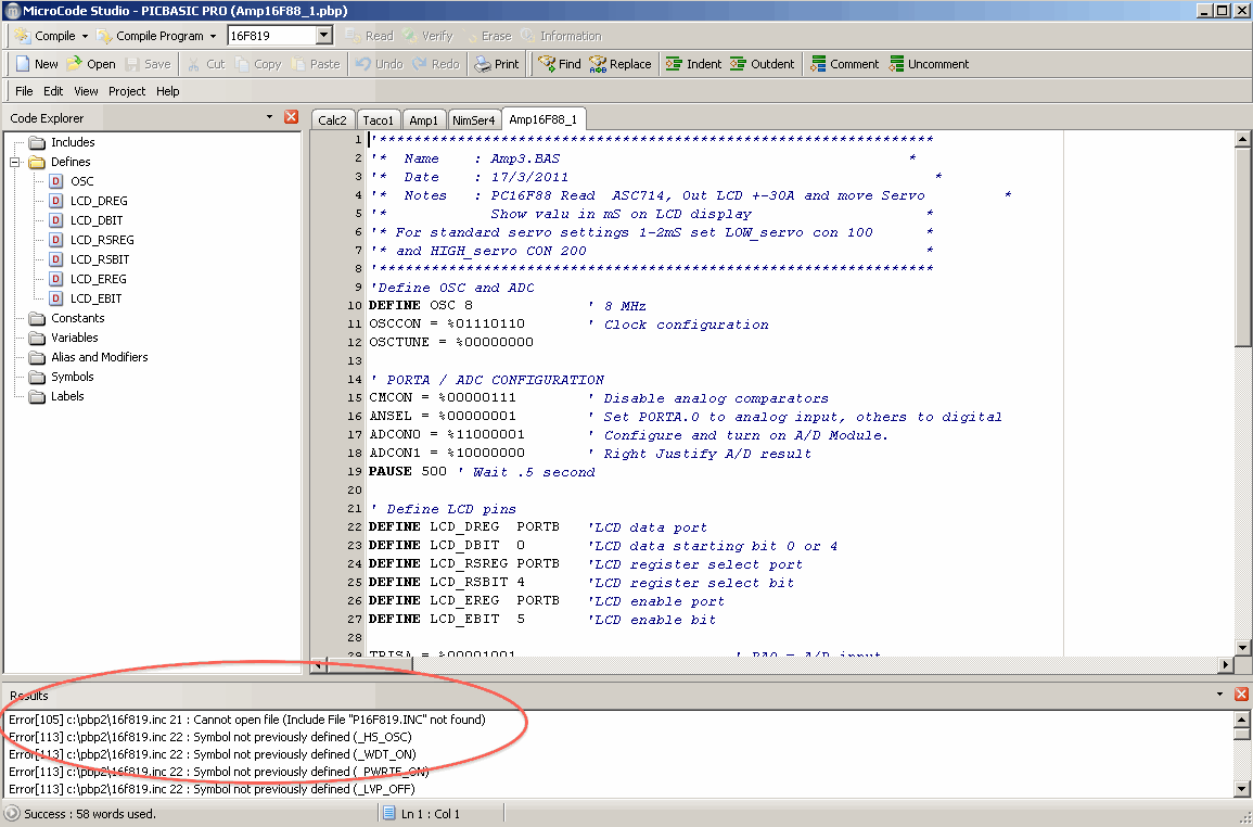

Today put in my 16F819. But get the Error message when compiling.
Cannot open file (Include File "P16F819.INC" not found. Its the same with 16F88.
At PicBasic homepage it says it support 16F819. Is this not thrue?
I have reinstalled everything but still not work. Please help.

Attachment 5298
Re: Installation. Include file not found?
MicroCode Studio is probably pointing to the wrong version of MPASM.
Go to View > Compile and Program Options > Assembler tab ...
The path above the "Find" buttons should be ...
C:\Program Files\Microchip\MPASM Suite - for 32-bit systems
C:\Program Files (x86)\Microchip\MPASM Suite - for 64-bit systems
If it's not, click the "Find Manually" button and point it there.
