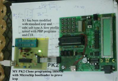

Like many I have the usb bug and not being a guru I was going to need help.I visted this forum since I use PBP and found this post"USBDemo, something to learn USB a little bit"great this would be the help I needed.I wired up the circuit and ran into most of the problems that were covered in the thread and many thanks to Darrel Taylor I got it to work.I have an X1 development board and I added a usb,standard icsp,programed a 18F4550 with microchip bootloader and upgraded to PBP2.60 and now I have a good development board.These are the steps along with pictures of the project.

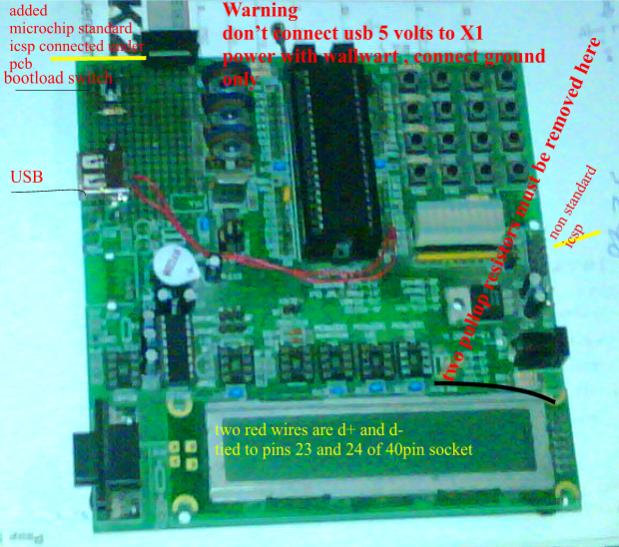

2.add the following in the farm area of the X1,a usb connector type B,A standard ICSP by that the common microchip :
pin 1 Vpp
pin 2 Vdd(not connected on X1,use wall wart connected to X1 power connector....
pin 3 GND
pin 4 data
pin 5 clock
3. add tact switch connected to RB4(pin 37 of 18f4550)40 pin texttool socket) and ground,pin 37 pullup to vdd using 10k resistor
4.Disconnect R9 and R10 used as pullups for SEEPROM,they interfere with portc3 and portc5 causing usb connection problems.
