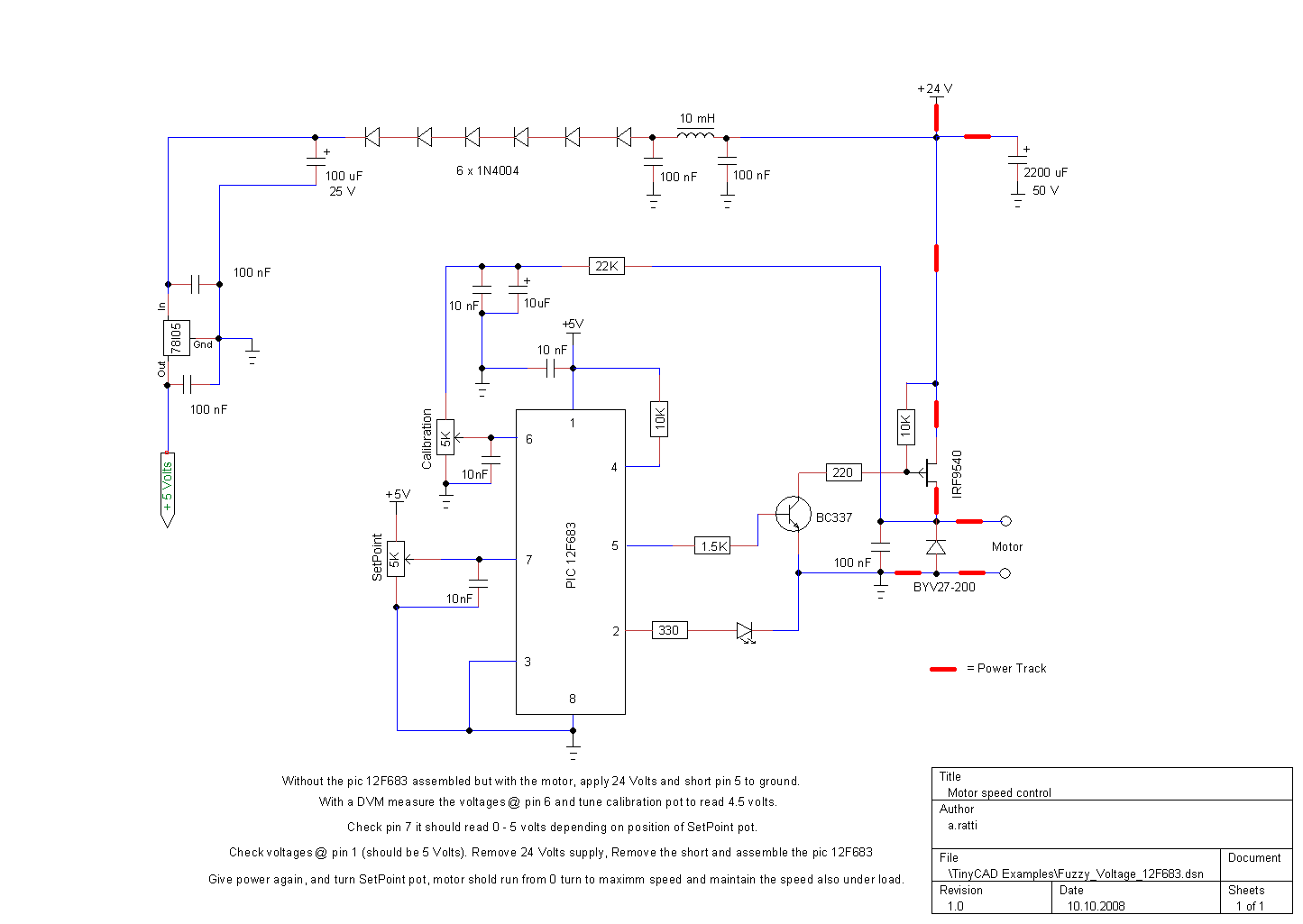

From the diagram it seems the valve will produce a linear flow function from 20% to 60% of the rated current. You can use a PWM to obtain the desired flow control.
The attached schematic has been designed to control the speed of a motor but it will be OK also for this proportional flow valve.
Cheers
Al.
