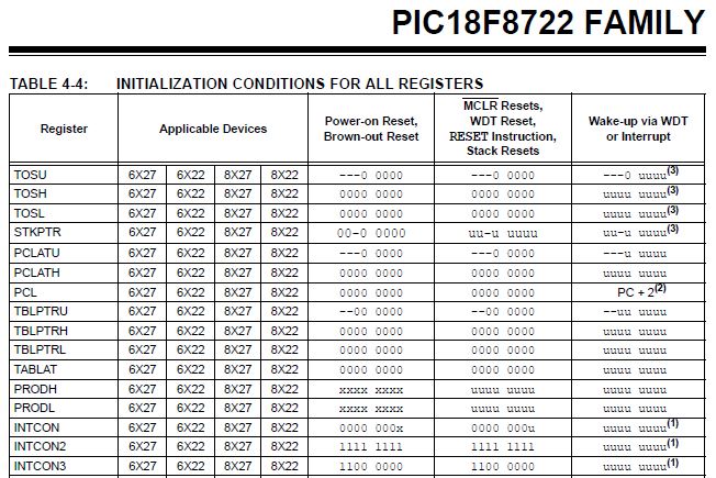

Yes, there are differences between the different RESET's.
The Initialization Conditions table in the datasheet shows the differences.
Attachment 5182
