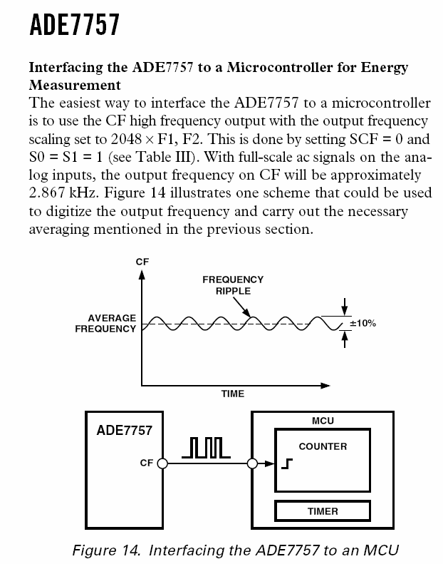

Here is an example from the data sheet on page 11.
Attachment 4960
Maybe more looking on google will find something more, but the interface part looks pretty easy. Code is probably the harder part.
