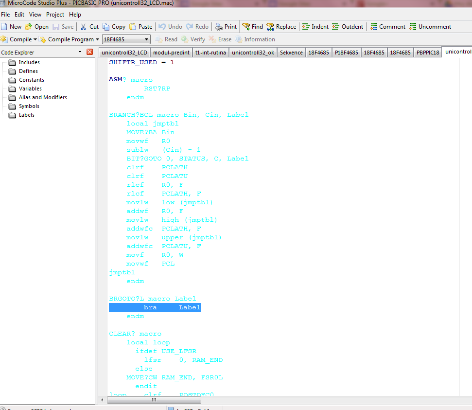

mac file at 560 line (blued) is it normal that this piece of macro is in asm, aqua color ?
Attachment 6784
whole macro code if means anithing

Re: Error[126] c:\PBP\PBPPIC14.LIB : Argument out of range (2054 not between 0 and 2
I have messing around this macro and line to which points this error126 (560)
and it shows on
BRANCH?BCL macro Bin, Cin, Label
local jmptbl
MOVE?BA Bin
movwf R0
sublw (Cin) - 1
BIT?GOTO 0, STATUS, C, Label
branch ?? .... so i was remarked branch line and error126 has disappear
ok I must use select case-goto instead, but now i tried putting
dummy 200 lines of
lcdout "test test test"
which increased hex for 3 times, but compiles correctly,
so obvious there is some bug with branch keyword after code grows.....
something like jump address can't be bigger then xxxx word....
but i don't know much about macros and internals, so I'm happy to bound this bug :)
It's not a bug, it's a feature :)
From manual:
Label must be in the same code page as the BRANCH instruction.
If you want to go out of page you must use BRANCHL.
But its twice bigger than BRANCH.
yes, tried with branchl works like a charm....
it's really overkill feature, night killer, but ok,
da nas dvojca moramo do ovamo poteč da riješimo bubu :P
so, error126 explicitly means that you are using branch out of page ?
maybe somewhere exist kind of RFM for errors ? this could save time too...
thank you for help :)
