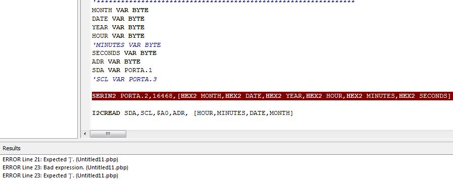

They both compiles here but gave the same error before I had all the variables properly declared:
Attachment 4798
Here, I've commented out the declaration of MINUTES and SCL and it gives pretty much the same error as you get. When I uncomment those declarations it compiles just fine.
So, double check your variable declarations.

Your correct I was rewriting some old code for 1302 to 1307 and deleted my variables geez
