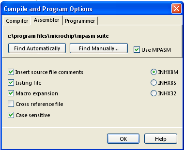

If you are using Micro Code Studio, try pointing it to the c:/program files/microchip/mpasm suite/
Attachment 4795
that should be where your new MPlab IDE files installed.
