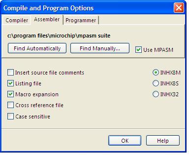

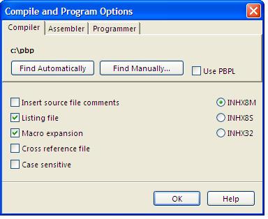

Martin,
In response to your PM message, yes for the 18F series you need to enable MPASM. Take a look at the attached pics. To get there go to View and Compile and Program Options...
I am not sure what the INHX8M and the other options are for, but I have them set in the default setting. Pressing the help button will not help much in clarifying what these options are for. Anyhow, the way you see it in the pictures is the default setting and it works.
Attachment 4436Attachment 4437
Oh dear. My MCS option window does not show that box....
I turned off MPASM in the next window, then back on again, nope no PBPL box.
My SW version About info shows me using V3.0.0.0 which seems the latest version.
Could my copy be messed up ?
PS. I said elsewhere that I must have kicked a black cat recently.... Make that two black cats.
Hi Martin,
What version of PBP do you have? MCS is up to version 3.0.0.5, but I think 3.0.0.0 should have had the check box. What does your About show under the Help menu?
Attachment 4439
Walter
I now have the PBPL option in V4.0.0.0 :-)
