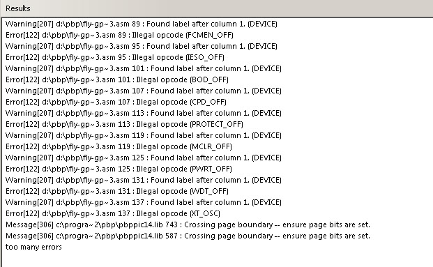

Hi All,
I changed my PC and installed W7/64.
So I reinstalled all my software (MCS, PBP2.60A, MPLAB an PICKIT2) and set them up as state in the previous posts.
In MCS, now using MPLAB to compile, I get a bunch of errors I didn't have before.
Can anyone explain what I have to do?

DEVICE is for the PM assembler, which you can't use with 64-bit systems.
With MPASM you need to use __CONFIG.
See this page ...
http://melabs.com/support/config_defaults.htm

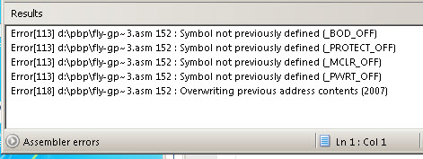

Well then...
I tried following code that still generates errors:
@ __config _FCMEN_OFF & _IESO_OFF & _BOD_OFF & _CPD_OFF & _PROTECT_OFF & _MCLR_OFF & _PWRT_OFF & _WDT_OFF & _XT_OSC
And here's the error list:
Attachment 5771
Any ideas what I'm doing wrong or missing?
Re: Windows 7 64 bit problem..can anyone help???
Actually, I noticed the syntax change in my PIC's INC file so I corrected as follow:
@ __config _FCMEN_OFF & _IESO_OFF & _BOR_OFF & _CPD_OFF & _CP_OFF & _MCLRE_OFF & _PWRTE_OFF & _WDT_OFF & _XT_OSC

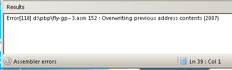

Nevertheless, I still get an error message:
Attachment 5772
You need to comment the default __CONFIG in the 16F690.inc in your PBP folder.
Use a semicolon.
Thanks Darrel,
It works fine now ;-)
