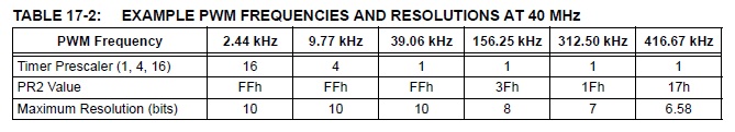

Duty = 400 ' 50-50 PWM duty-cycle
T2CON = %00000100 ' timer2 on, 1:1 prescale

CCP1CON = %00001100 ' setup for single-ended PWM output
PR2 = 199 ' setup for 10kHz
PSTR1CON = %00000001 ' P1A is driven by PWM
