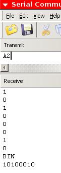

HSERIN [HEX X]
HSEROUT [DEC X.7,13]
HSEROUT [DEC X.6,13]
HSEROUT [DEC X.5,13]
HSEROUT [DEC X.4,13]
HSEROUT [DEC X.3,13]
HSEROUT [DEC X.2,13]
HSEROUT [DEC X.1,13]
HSEROUT [DEC X.0,13]
HSEROUT ["BIN",13]
HSEROUT [BIN X,13]
http://www.picbasic.co.uk/forum/atta...1&d=1260790030
