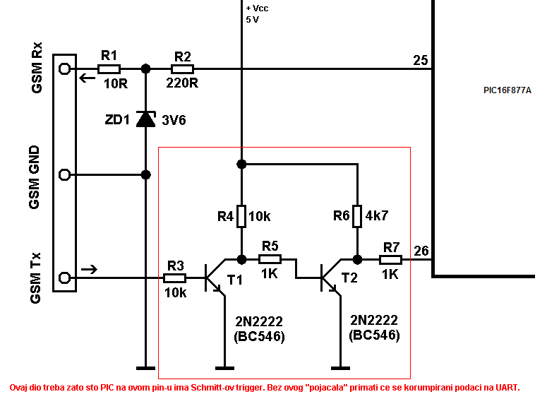

To connect the GSM to PIC i used that schematic
http://www.picbasic.co.uk/forum/atta...9&d=1236671766
Without the "amplifier" the pic doesn't recognize the GSM!
