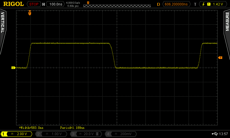

The SK6812 is similar to the, perhaps more common, WS2812B in that the overall bit-time is the same (1.2us) but the timing is slightly different. The WS2812B uses 350ns/900ns for '0' and 900ns/350ns for '1'. The SK6812, on the other hand, uses 300ns/900ns for '0' and 600ns/600ns for '1'. Here's a table from the datasheet:
The code included in this article is hardcoded for 64MHz system clock and achives the required timings, as can be seen in the following images:

1-pulse timing:
