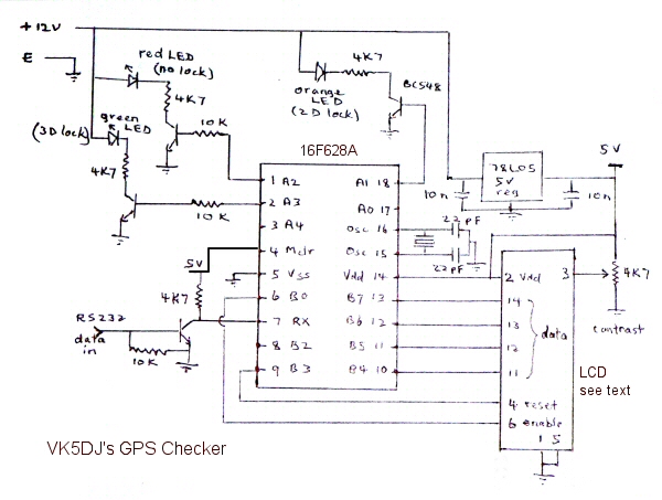

Three digital ouptuts of the 16F628A provide switching though small NPN transistors to operate the indicator LEDs or sounder. A green LED is labelled "3DLock", an orange LED labelled "2D Lock" and a red LED and sounder are labelled "NO Lock".

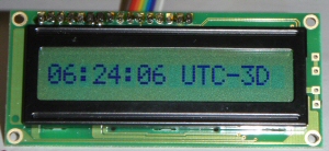

The LCD output is to a single line LCD. The 16 character LCD I used is one of those that treats the single line as two lines of 8 characters. The first 8 characters are printed from 1,1 while the second half of the line is printed to 2,1 resulting in one line of 16 characters. It just requires a little more thought when constructing the print statements.
The LCD is shown indicating current UTC time with an indication that a full 3D decode is taking place.
A 3D decode confirms that the 10 MHz output is GPS locked and reliable.

Most GPS are either locked to 4800 baud output or may be enabled for 4800 baud. The USART in the PIC is set for 4800 baud receive using asynchronous 8 data bits, no parity and 1 stop bit. Note that once the receive port has been set (PortB.1) the transmit port (PortB.2) is no longer available for general IO.

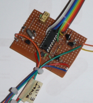

Although not shown, the PIC is a 16F628A. The transistors can be any general purpose NPN type. The crystal is an 8MHz type, although any frequency would work providing you match the crystal definition in the basic program.
If an operator wants an audible indication of loss of lock a piezo sounder could be connected between 12V and the collector of the transistor driving the RED LED.
If your GPS has a TTL output rather than RS232, remove all the components connected to pin 7 (RX) and replace with a single 10K resistor between pin 7 and the output of your GPS engine. The function of the transistor in the input to the RX of the PIC is to invert the sense of the data and provide some protection from the negative going RS232 data - neither of these are needed if you use a TTL input.
